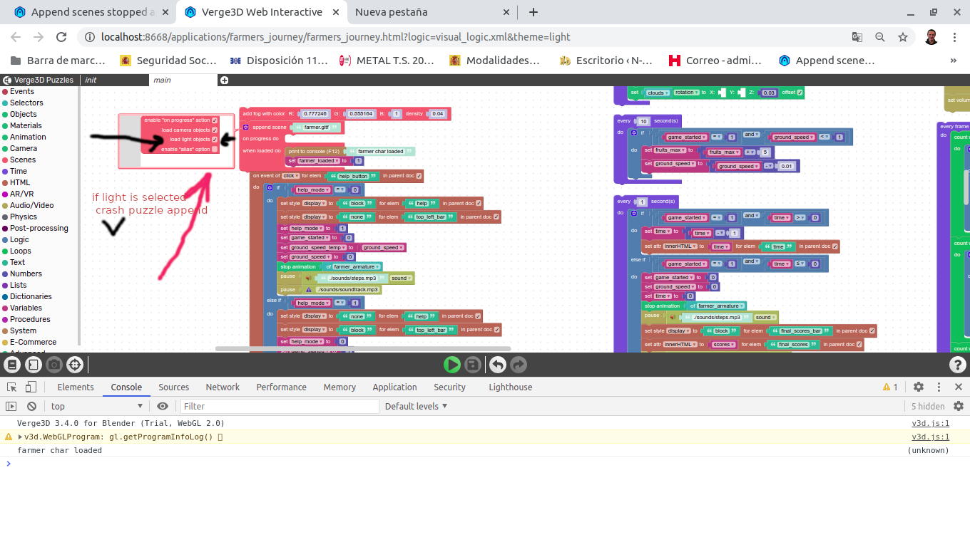

    #33707
    There are plenty of words with the attached capture, as I said, you deselect the light in the append puzzle and everything works normal again, I just had to create a blender file with the character’s mesh and a light,
    You can download the two blender files, and code completed in:
    https://www.n-dimensiones.es/crash_append/farmers_journey.zip
    Greetings and I hope I have helped without you having to wait for my game although it is already very advanced and adapted to verge3d 3.4
    #33742
    Farmer works fine too! Looks like we fixed the issue internally. Let’s wait for the next Verge3D update.
