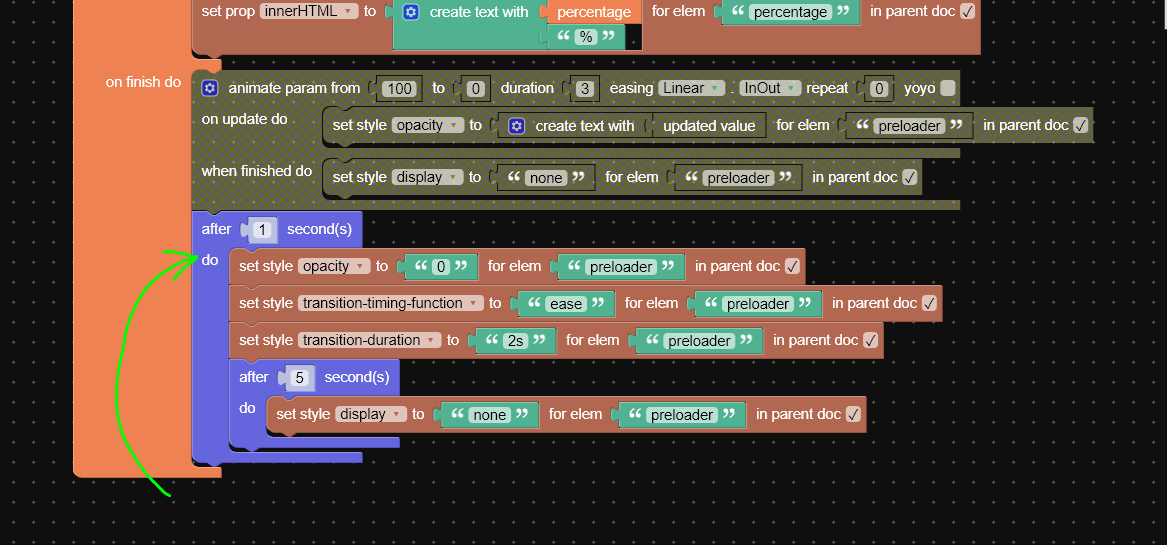

jdhutchinsonCustomerThanks both for replying.
FWIW, I followed the v3D preloader tutorial, where they explain using puzzles to show 100% loading.
I have compressed assets ticked in puzzles, and enable LZMA compression in the blender file. Is this enough?
See attached. I have an annoying method for the startup puzzle which I have to use as a workaround for animate param not being available in the init tab. I did report this as a question too separately somewhere.
