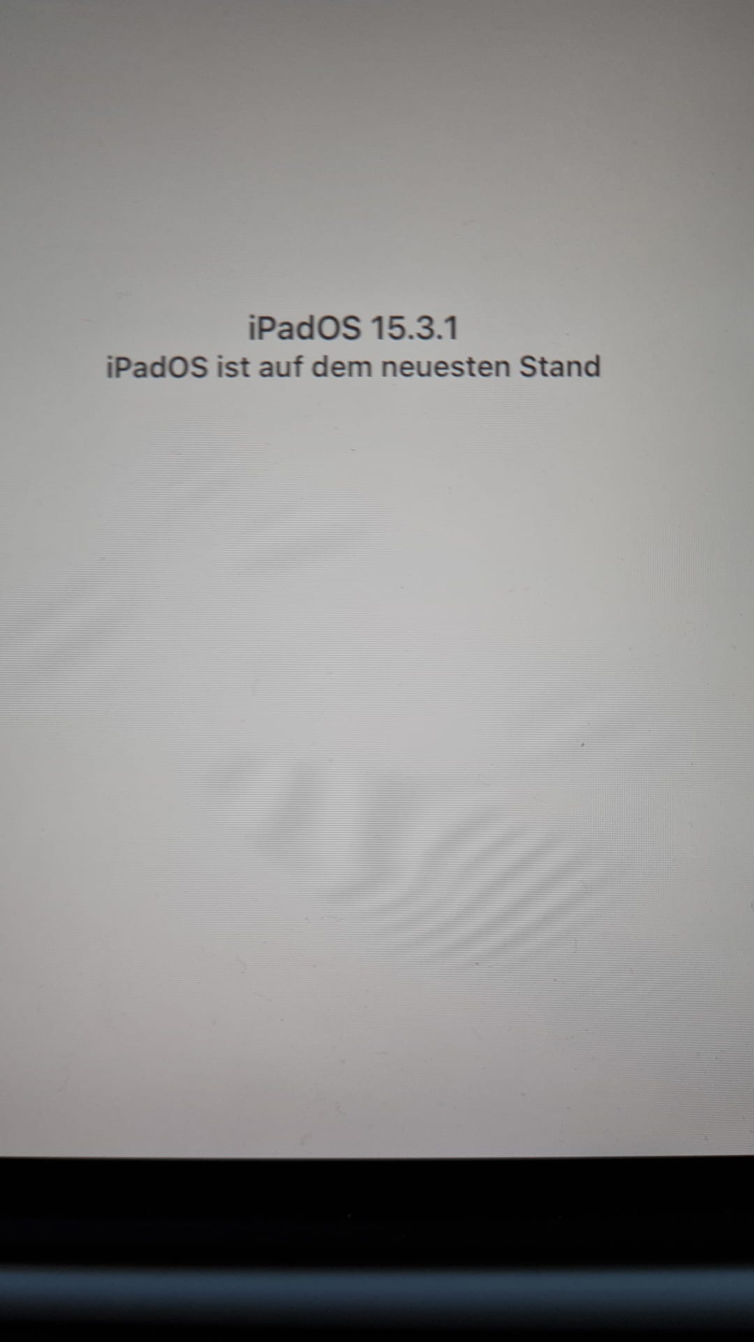

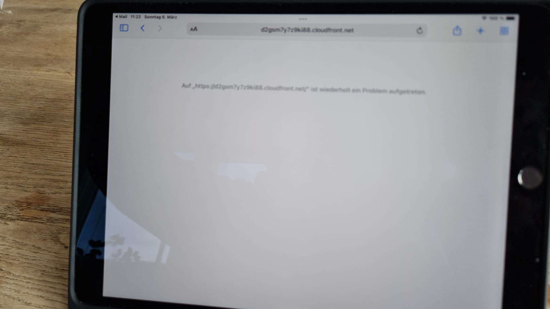

    While all seems to work fine on PC’s running different browsers I am experiencing two issues on iPadOS & iOS 15.3.1 and Android 9.
    The iPad functionality is a deal breaker for my client, so that has the higher priority.
    My client gets an error & its not loading the configurator.

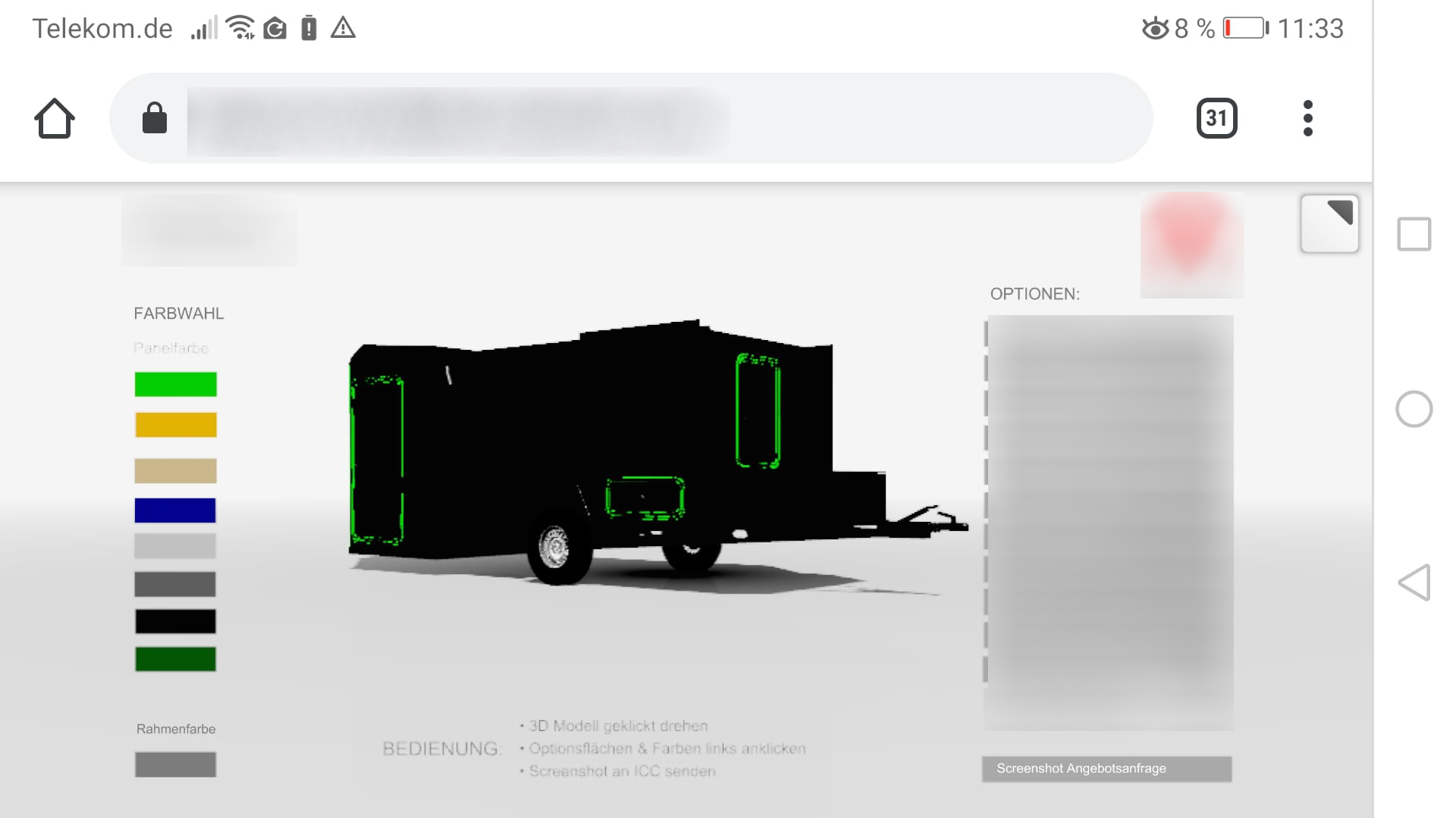

    You can see the Android issue on the attached screenshot.
    The trailer displays black.
    On more modern Android devices & in PC browsers this seems to be not the case I am informed.The trailer shows up bright green as intended.

    it looks like your app loads a VERY big texture 12k x 6k for cloud environment. This likely causes memory overflow on mobile.
    #50008
    also might use only power-of-two textures as they are more efficient
    https://www.soft8soft.com/wiki/index.php/NPOT_Textures

    The aspect ratio of 1:2 comes from the fact that it is the equirectangular image used as cloud reflection.
    12000×6000 is a normal size for an equirectangular image, no?
    I did already use a jpg instead of an hdr or exr which would be huge.
    This jpg. is 1.67Mb big (see attached), whats the alternative?
    I can not burn these reflections on the meshes as my clients need to change tons of color around. Alternative solution?
    I have two other textures which are small 320×198 and I will turn them to POT tommorow.
    this is too big -try to downsize it to 4096 x 2048. You don’t need extra precision for reflections anyway.
