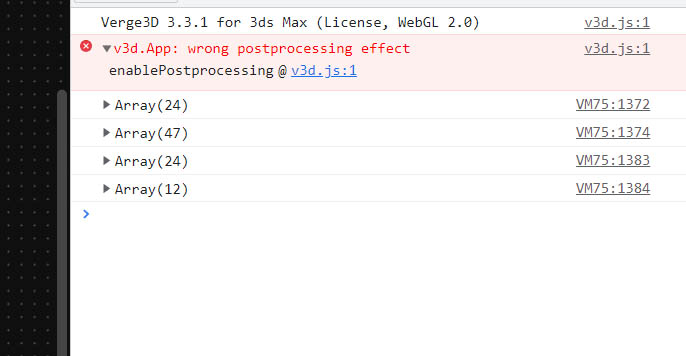

    Hi All. I have a problem with AO. I enable AO in my 3dsmax plugin, hit test…an i see my scene with AO. That’s ok. When i save my gltf to the Verge3d folder, and uses puzzles, i cannot see any AO. The message in the console is :
    V3d.App: wrong postprocessing effect
    enablePostprocessing @ v3d.js:1
    Any idea?

    I did not use any AO puzzle. I Only enabled AO in 3dsmax plugin ( export settings). But in the consolle i see this error.

    I see from the console that your app uses version 3.3.1. You should update it by clicking the update button in the App manager.
    #48732
    karonte
    Yes thanks. I forgot to press it . Now all it’s ok. Yuri, sorry for the stupid question !
