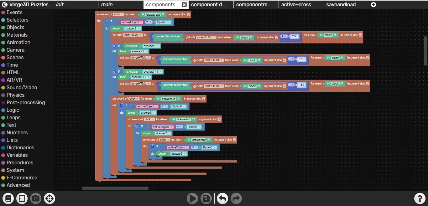

Participantactually. now i did the puzzles like this. to show my component and add price.
but problem is . when click on drawer but, after 4 time the component is finish. but if you click more. it will add more price. how can i stop it?
and please is there any way i can make this puzzle more smaller with same functions?thank you so much

Yuri KovelenovStaff2020-11-01 at 11:37 am #34833farzinkhodadadi
Participantcan you please tell me another way to do this function. and if its possible make the puzzle smaller?
and also dont have the problem that every time adding price more and more by clicks.
that would be great2020-11-03 at 7:19 am #34898farzinkhodadadi
Participantcan you please help me, about that click. thta you mention its a bad idea. how can i make it better?

Yuri KovelenovStaffThe problem is that in your current setup, once the user performs a click, new JavaScript click event listeners are created. This means that on the second click there will be additional events fired which may behave unpredictably. Therefore you should not use nested event puzzles. Try to reorganize your puzzles to avoid this situation.

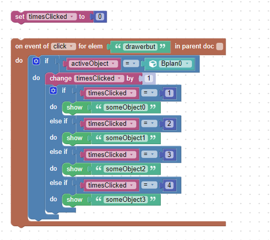

thank you so much for your timeHi, it seems that you want to progressively show some objects after each click. If that’s the case then it can be done by counting the amount of clicks (by saving it in some variable) and testing if it’s the first time the object was clicked, the second, the third, etc… All of that inside a single “on event of” puzzle.
Like this, for example:
