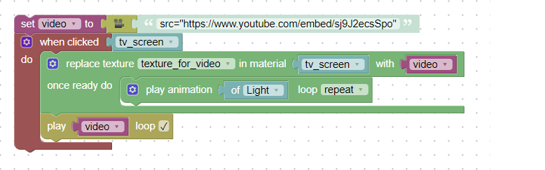

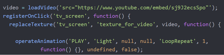

CustomerHi, I tried replacing the src video link in puzzle as well as in visual_logic file
I want to use youtube video for my project and when I change it on visual_logic, it would update automatically on my project, but maybe I am doing something wrong please check the attached screenshot.Attachments:
2020-09-21 at 8:28 am #33099
Yuri KovelenovStaffYou can try using the canvas texture feature
https://www.soft8soft.com/docs/manual/en/puzzles/HTML.html#create_canvas_elem

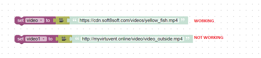

Customerhere is another problem
this below link is not working on my projecthttp://myvirtuvent.online/video/video_outside.mp4 (NOT WORKING)
https://cdn.soft8soft.com/videos/yellow_fish.mp4 (WORKING)

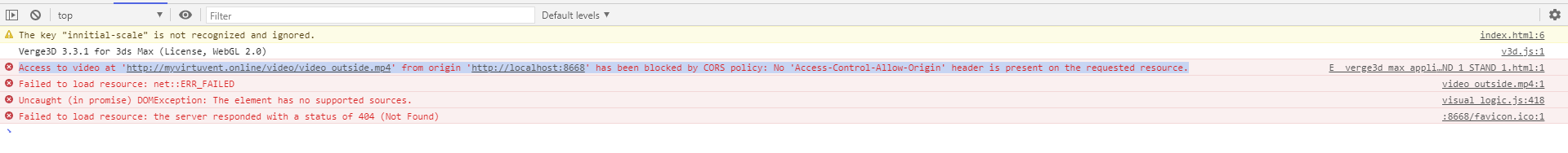

CustomerAccess to video at ‘http://myvirtuvent.online/video/video_outside.mp4’ from origin ‘http://localhost:8668’ has been blocked by CORS policy: No ‘Access-Control-Allow-Origin’ header is present on the requested resource.

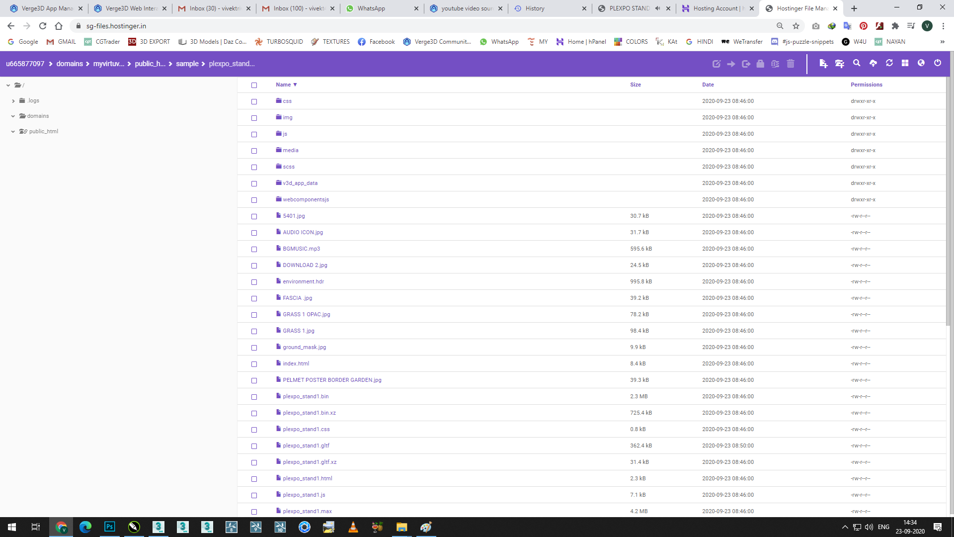

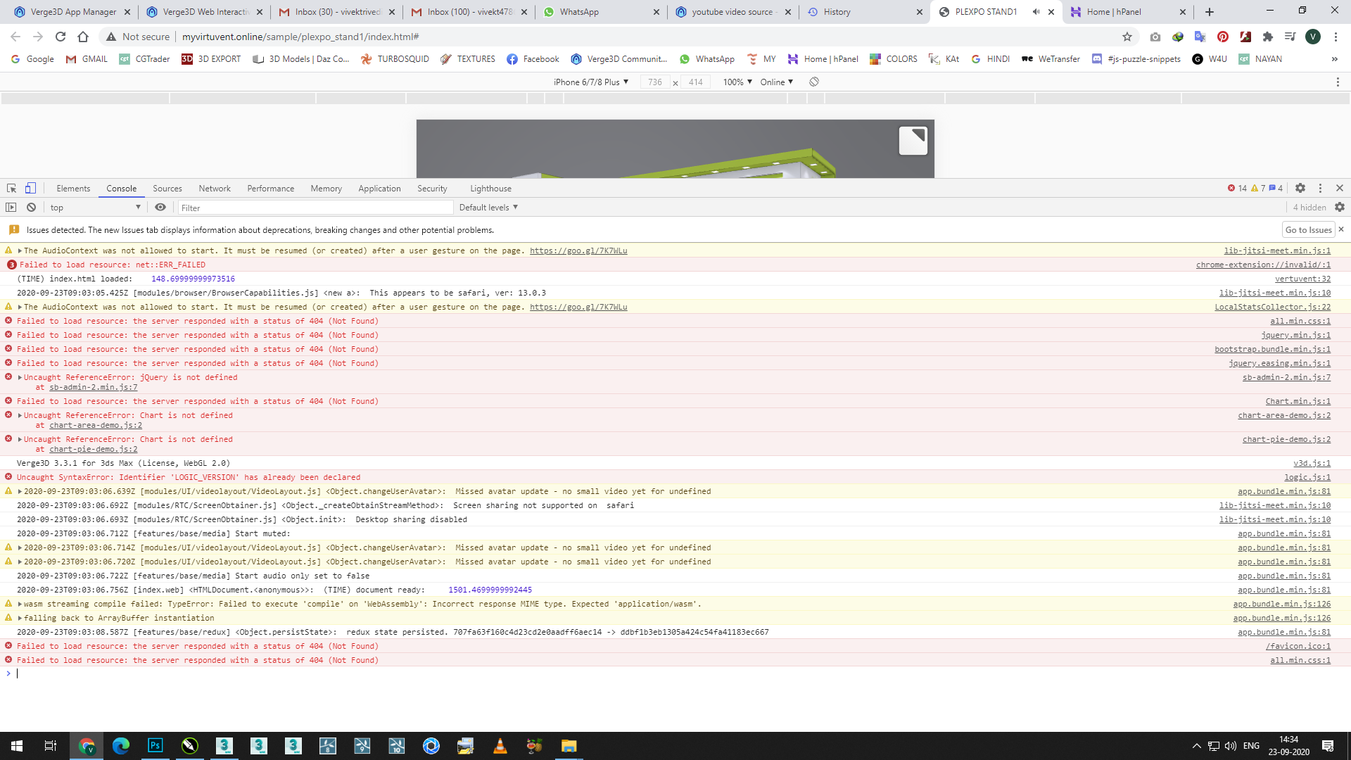

Customeryes it prints many errors, most probably this is my last query and doubt as i learned lots from forums and able to solve many problems myself.
Attaching two screenshots of error and my hosting directory, simple thing i want if i replace some texture in my directory i should be updated in my design.Manny thanks in advance
