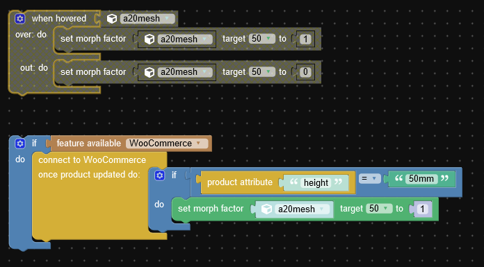

    I seem to have a similar problem with the 3D model not reflecting the woocommerce attribute change.
    What I want to achieve is when the user changes the “height” attribute, the middle section of the 3d model prolongs to 50mm. The basic height is 45mm.

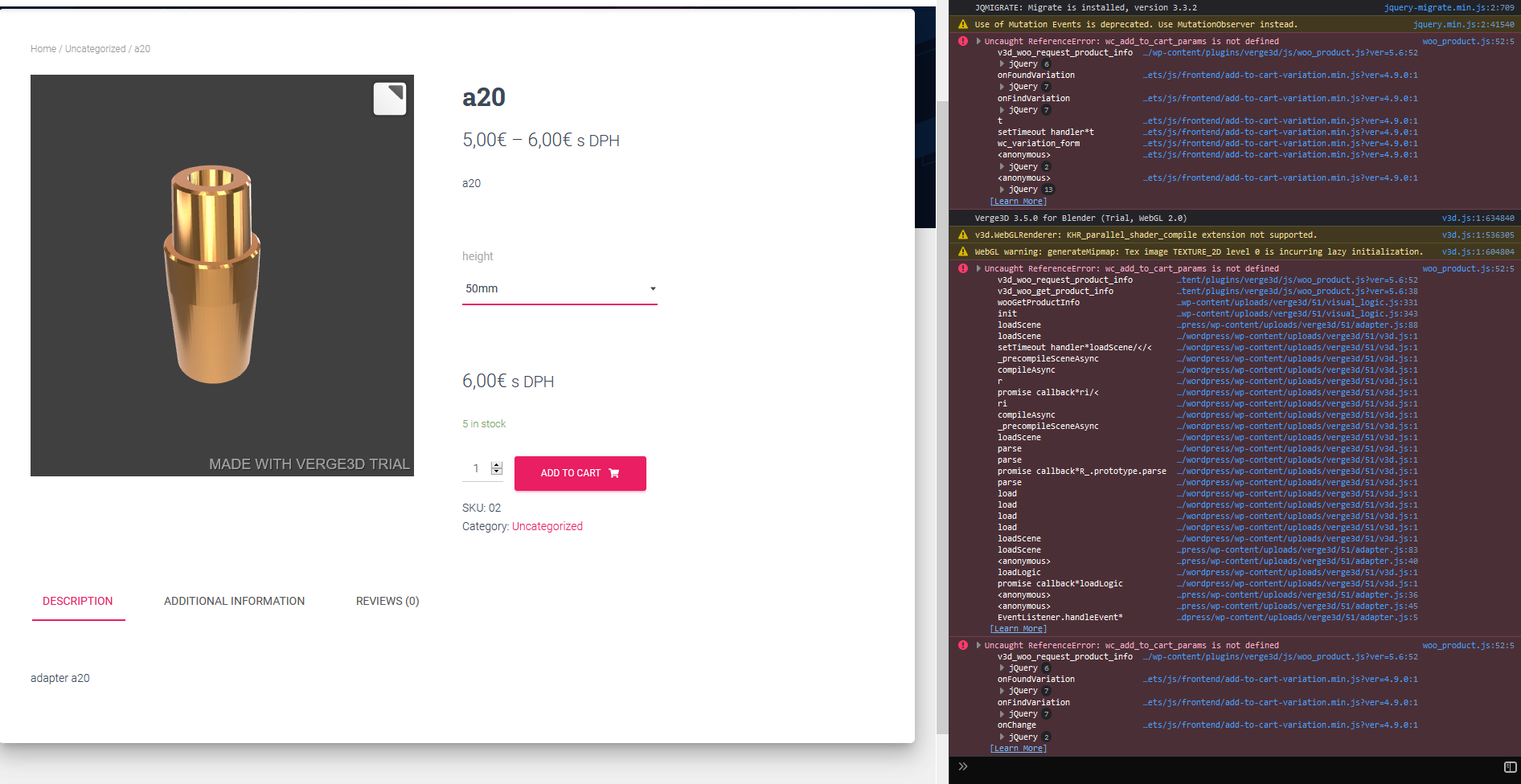

    When I test the morph factor in the puzzles editor with the command “when hovered”, the model changes, but it doesn’t seem to work with woocommerce. When I change the attribute, the model remains the same. And the console displays the error as seen in the printscreen.
    One other anomaly is when I change the product attribute from the default 45mm to the first option “choose an option”, the cart button gets disabled and isn’t available even if I reselect “45mm” or “50mm”.

    – changing the puzzle if/else statements to include all of the four combinations of height (if 45 then 0, else 45 = 1; if 50 then 1, else 50 = 0).

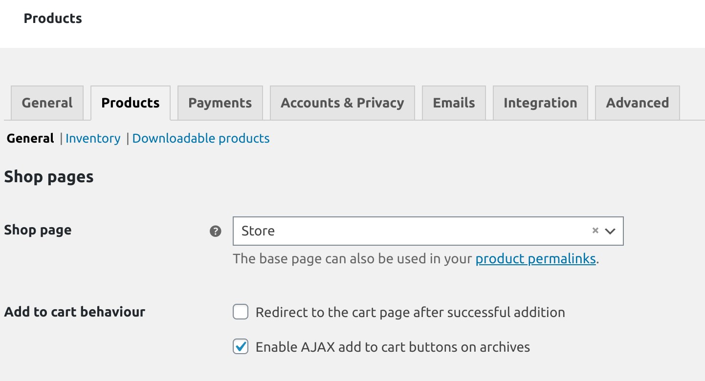

    #37338
    You can try enabling the option ‘Enable AJAX add to cart buttons on archives’ in WooCommerce settings and see if it helps:
    #37339
    tomshawke
    Hi, Yuri,
    Thanks so much for the prompt reply – enabling AJAX did help! :good:
    Cheers
