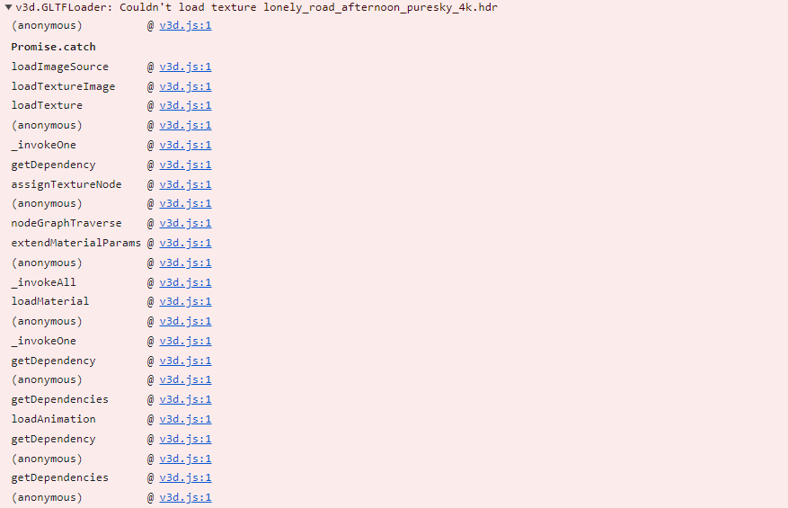

    Hello. I am trying to run Verge3D application on Windows server 2019 – IIS 10. But I am getting an error regarding the .hdr file. That’s why the model looks dark. We tried introducing the .hdr file in the MIME settings and adding the following codes to the web.config file, but it still did not work. The screenshot of the error is attached. Thank you for your help.
    <configuration>
    <system.webServer>
    <staticContent>
    <mimeMap fileExtension=”.gltf” mimeType=”model/gltf+json” />
    <mimeMap fileExtension=”.hdr” mimeType=”image/vnd.radiance” />
    </staticContent>
    </system.webServer>
    </configuration>

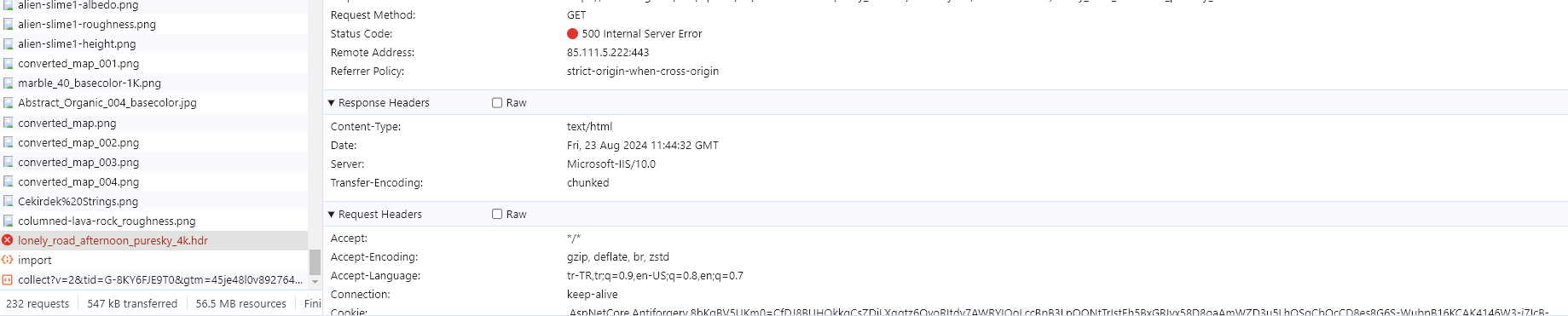

    Please open “Network” tab in Chrome “Developer Tools” to see more info why the asset is not loaded.
    #76938
    gulumse716
    Attached is the screenshot of the “Network” tab in Chrome “Developer Options”.
    #76940
    gulumse716
    It gives this error even though the file with .hdr extension is on the server.
