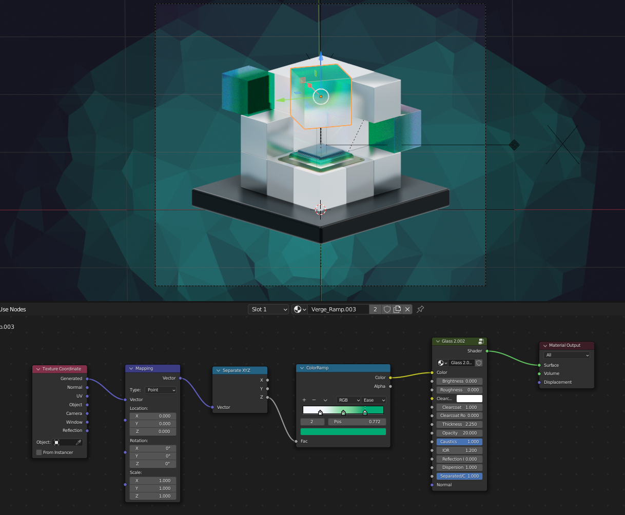

    Hi,Verge3D Team
    I have encountered a problem with the glass material.

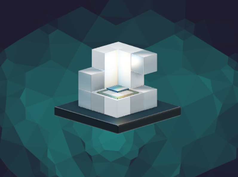

    As shown in Figure 1, this is my rendering of Eevee in Blender and everything is working as I expected. But it can’t be displayed in Verge3D, which bothers me, as shown in Figure 2.
    I guess it’s because I use a material preset “Glass 2.4”. The nodes in this preset are very complicated, but it works very well. I’ll include a link to this preset below. I would appreciate if you could help me to solve this problem. (Or you can tell me which nodes in the preset are causing the above problem)

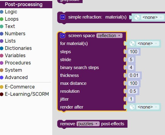

    You use SSR in the scene but it does not supported, instead of Blendder SSR you need to use special SSR puzzle.

    Thank you for your reply, but I don’t quite understand what you mean.
    Because I followed your official tutorial (Swiss Army Knife) to open the SSR. what is the special SSR puzzle you are talking about? Can you show me, thank you very much.
    #51947
    It’s here.
