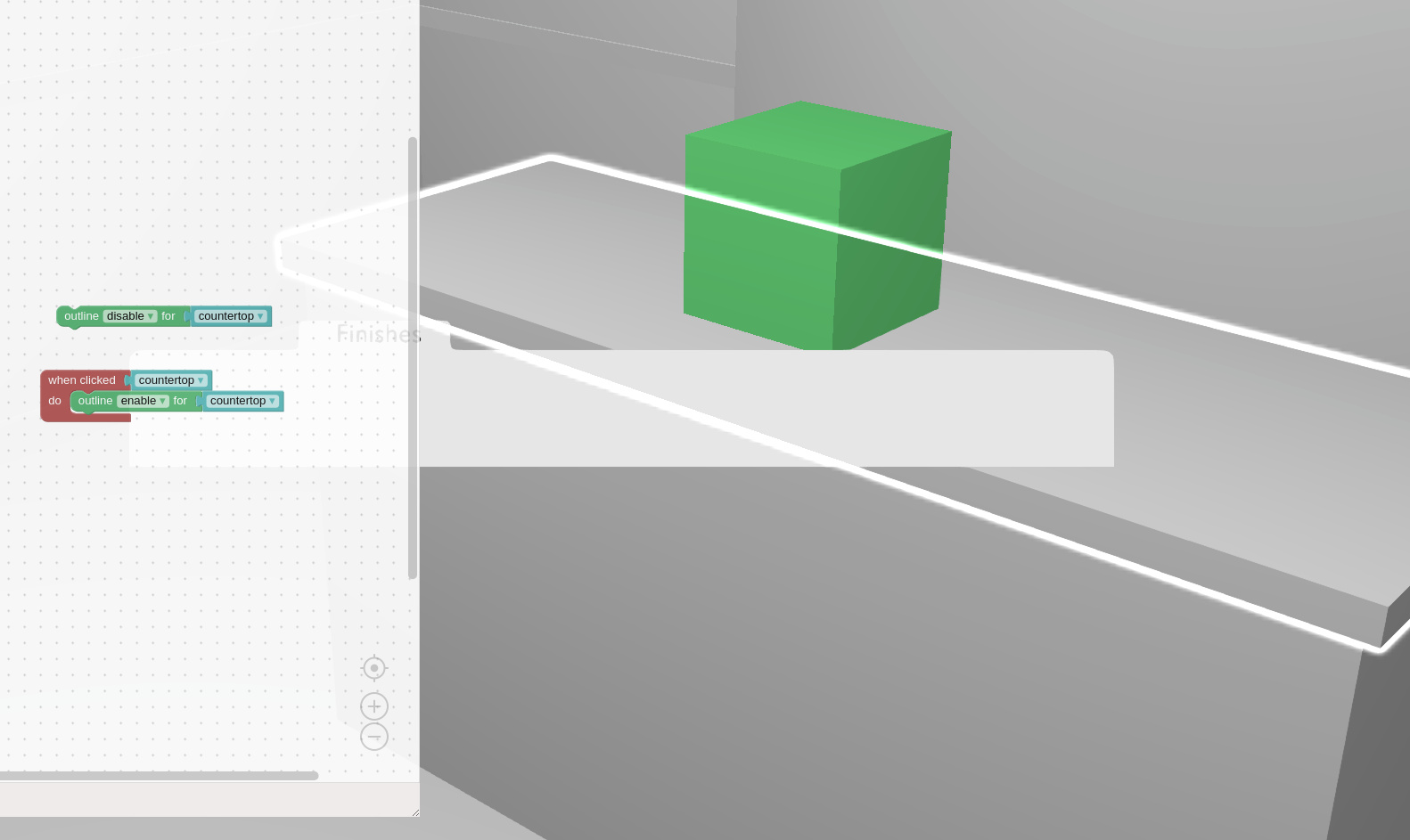

CustomerI’ve made test apps where if you click on an object, things happen, but for some reason it’s not working in a different app. I wanted it to just enable outlining, or even ‘print to console’ and nothing happens. Is there some ‘clickable’ setting somewhere that I’m missing? Because I’ve done it before and it worked.

CustomerOkay, this might sound counterintuitive, but I was able to get it to work. I had thought that I could make a menu pop up in front of the camera, with a bunch of icons by giving it an animation, and then when you clicked on an object, the animation would play. I parented this to the camera, right in front of the lens, but positioned down below where it would be out of the way.
Deleting this element makes it all work fine. Also, hiding it as the app loads works, then unhiding it, works fine. But for some reason the animation doesn’t work. Is there a better way to create an interface like I’m describing, or is this another Mac mystery? I can live without animated interface, just hiding and unhiding, but I’d rather have it animated.

Yuri KovelenovStaffI think I found the reason for animation not working. There is currently a limitation that objects directly parented to the camera cannot be animated. To overcome this, one should use an empty object as a proxy. Attached an example.
