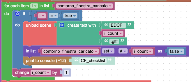

    I have created a webGL configurator where there’s a main scene (a house) and elements that can be applied on the house’s surfaces (windowsills, window frames..).
    Sometimes switching from one element to another of the same category, instead of replacing the object, it overlaps on the current one in the main scene.
    I’ve exported from Blender scenes with .gltf for Verge3D export format, the material applied on these elements is the default one generated from Blender.

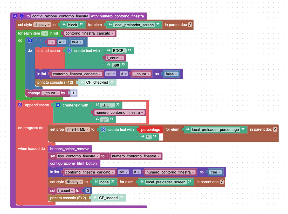

    Every scene/.gltf is on click loaded. I’ve used the same for loop jewerly configurator project. (See the attachment)
    Every time the user click on a button the .gltf in the current scene is unloaded and replaced by the selected one.

    I think this loop doesn’t work

    Francesco
    The problem was that the array list was too short!
