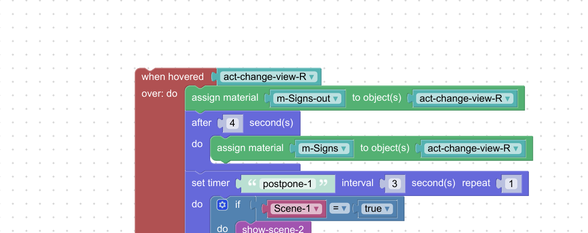

    Thanks for sharing the test project! We managed to find the cause of this issue. Actually it’s an error in the hover logic. There should not be any “every frame” puzzle around “when hovered” as it will cause thousands of material changes which eventually kills the app performance. See how it should be:

    Oh, I thought I needed the frame listener in VR mode. I changed it and don’t use it now, but the IBL lighting still turns off when I switch the scene. Everything else works fine, as before.
    I tested with the Chrome WebXR emulator and a Cardboard device on my iPhone 5 SE.
    The WebXR emulator overrides WebXR API with Polyfill. Has it something to do with Polyfill not supporting the IBL light switching? :unsure:
    Does it work for you on other devices than the Oculus Quest?
    #32006
    Yep, it was another bug with the environment switching. Check out the upcoming Verge3D pre-release to see if it finally works as it should be!
