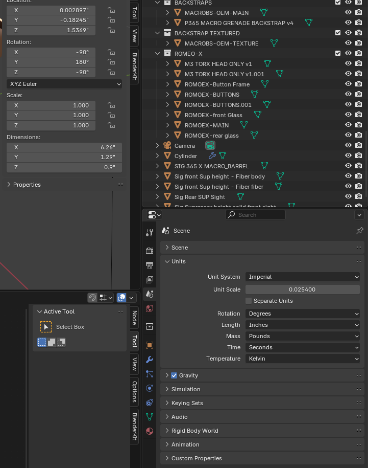

CustomerI checked my blender file and i do believe the units are setup correct. See screenshot.
2025-04-22 at 6:32 am #81468
Alexander KovelenovStaffBlender uses metric system internally, so this is what will be exported to Verge3D. Imperial is set only for Blender UI. Hence, to be consistent with the internal metric system the “Unit Scale” parameter should be kept as 1.
