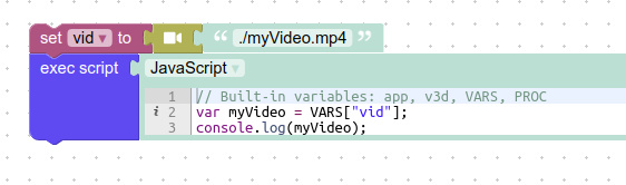

    Hi, I wanted to set the time of the video by programming. Of cource the easiest would be to have a puzzle like
    “set second of (video) to (int) sec”
    As it is not available today, is there a way to achieve this with javascript? I do know the right functions for it, but it is neccessary to catch the Video object from the DOM. And in this case I dont think it is not possible as it is part of the 3D scene?
    Thanks for your answer
    #35672
    Here you go:
    #35790
    justin_blender
    Oh thats how to do it. Thank you so much.
    I really have to say this is the best customer support I have ever experienced!
    For everyone after me following this thread. This is how you will set the time with the script completely.
    var target_time = 5;
    var myVideo = VARS["video"];
    myVideo.source.currentTime = target_time;
