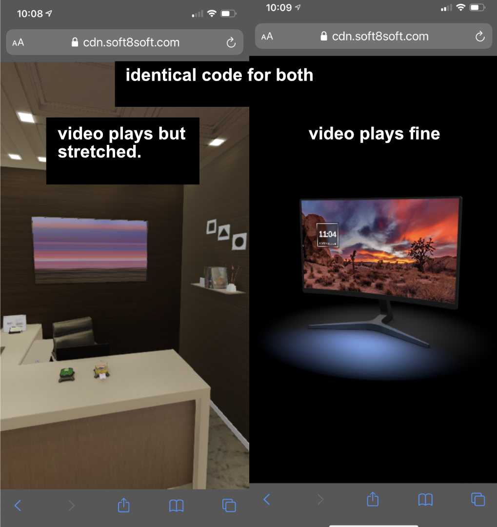

    Base system WebKit…. problem is scene in both Safari and Chrome.

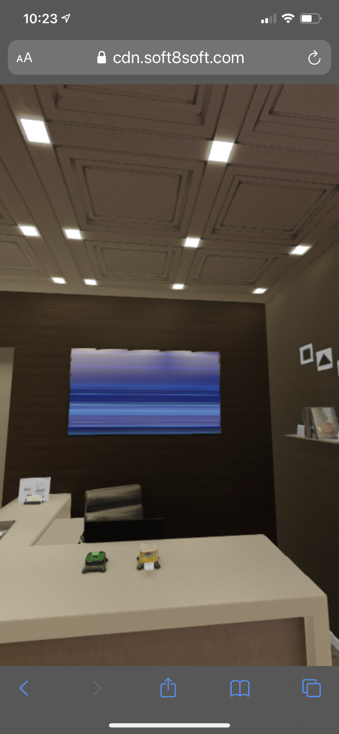

    PROBLEM: video replacement textures work sometimes
    DESKTOP:
    Chrome – works every time
    Safari – doesn’t work with larger scenes ( video will playback but is stretched).
    NOTE: the more memory used by the application the more likely the issue will be seen.
    High memory use case:
    https://cdn.soft8soft.com/AROAJSY2GOEHMOFUVPIOE:f2f27a4091/applications/test_gallary_textures/test_gallary_textures.html
    Low memory use case:
    https://cdn.soft8soft.com/AROAJSY2GOEHMOFUVPIOE:f2f27a4091/applications/video_texture/video_texture.html
    Videos tested: https://cdn.soft8soft.com/videos/yellow_fish.mp4
    as well as my own mp4 inside associated test files.
    MP4 video codes are both H264

    I found out what the issue was…. it was simpler than I thought.
    In my case… I had assigned a Generated UV map to the screen object.
    I since replaced that with the UV Map node directly taking the UV output and inserting it directly into the texture Vector and it works perfectly after having to rotate the UVs about…but all good…working in iOS now.
