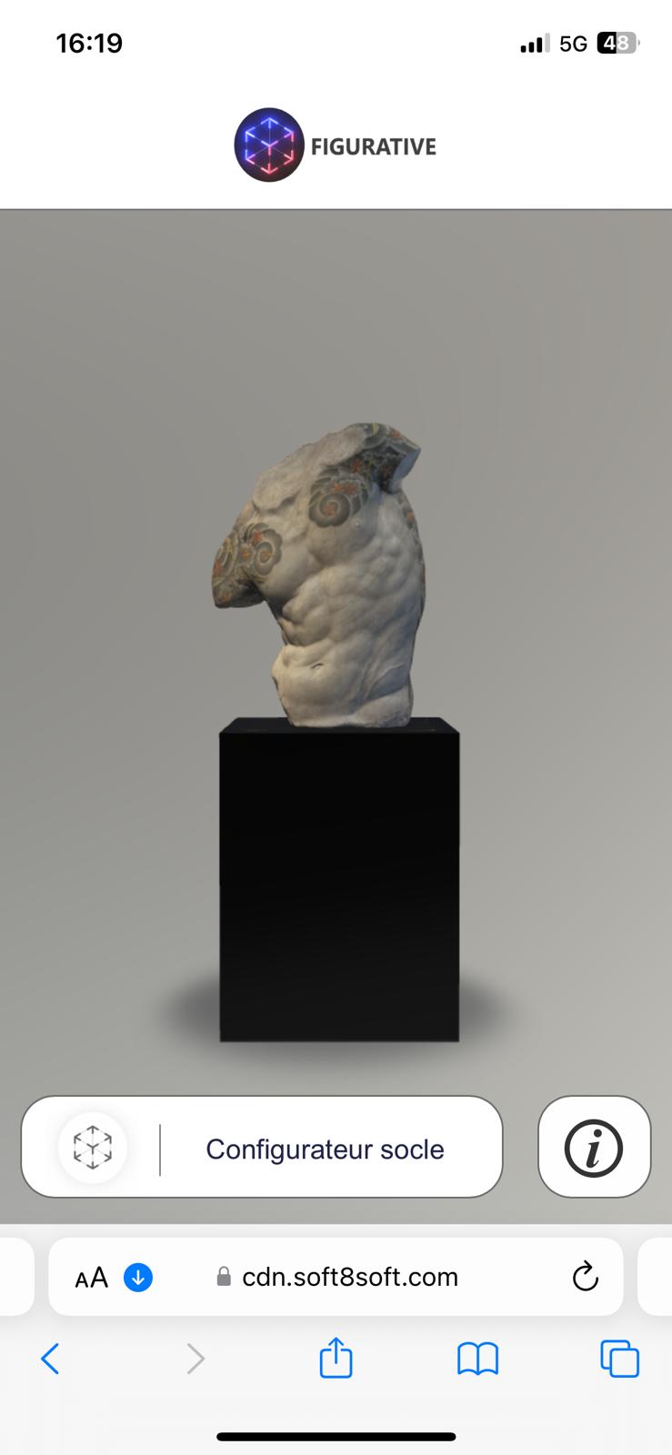

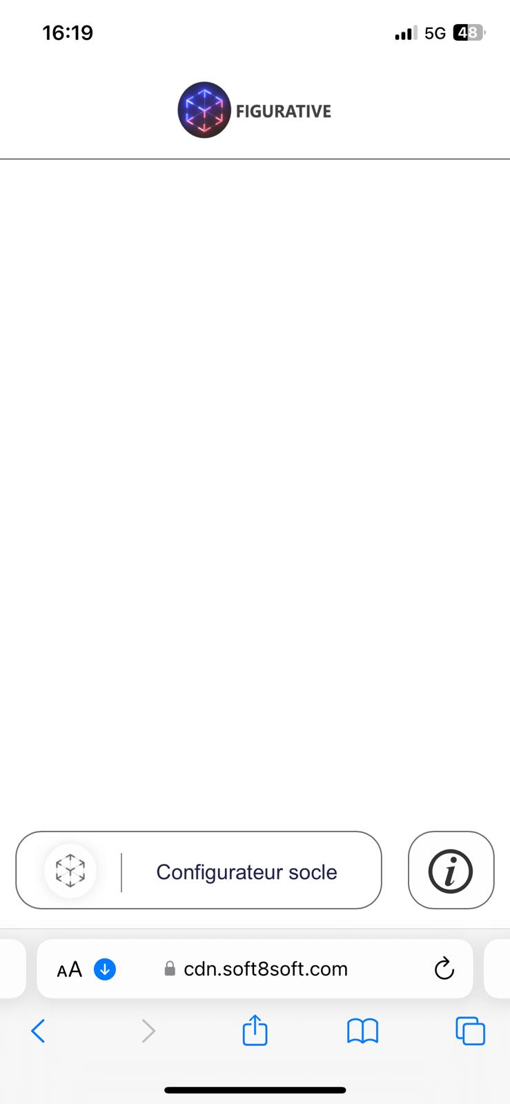

    It appears that my app doesn’t display the verge3d part.
    It happens maybe 20% of the time. I need to reload the page until it works fine.
    I would guess there is a conflict somewhere but I have no idea where to look..

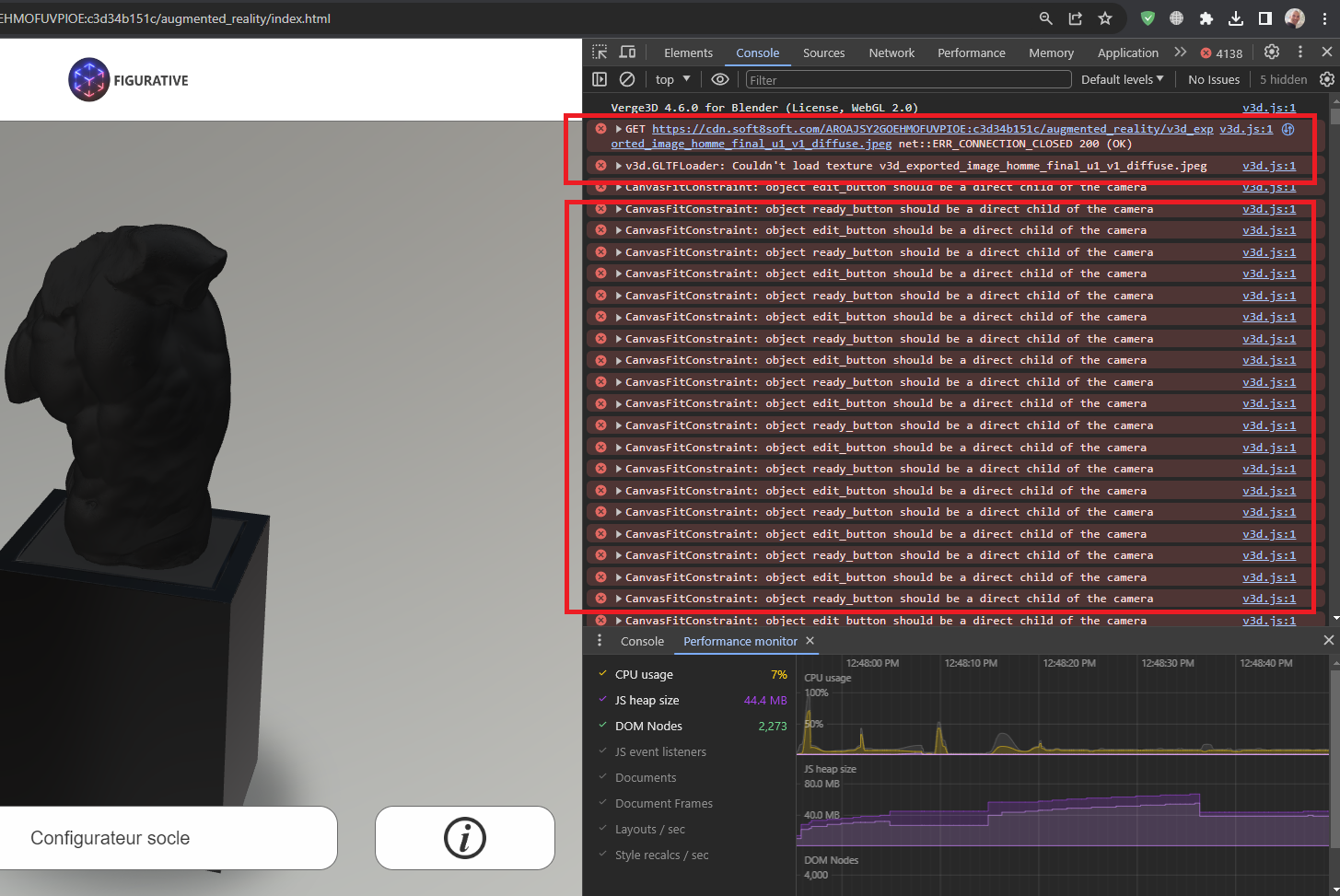

    First, disable “Fit to canvas” constraint. It’s not working in your app (ready_button is not a direct child of the camera). Then press F12, switch to the mobile view and see errors.

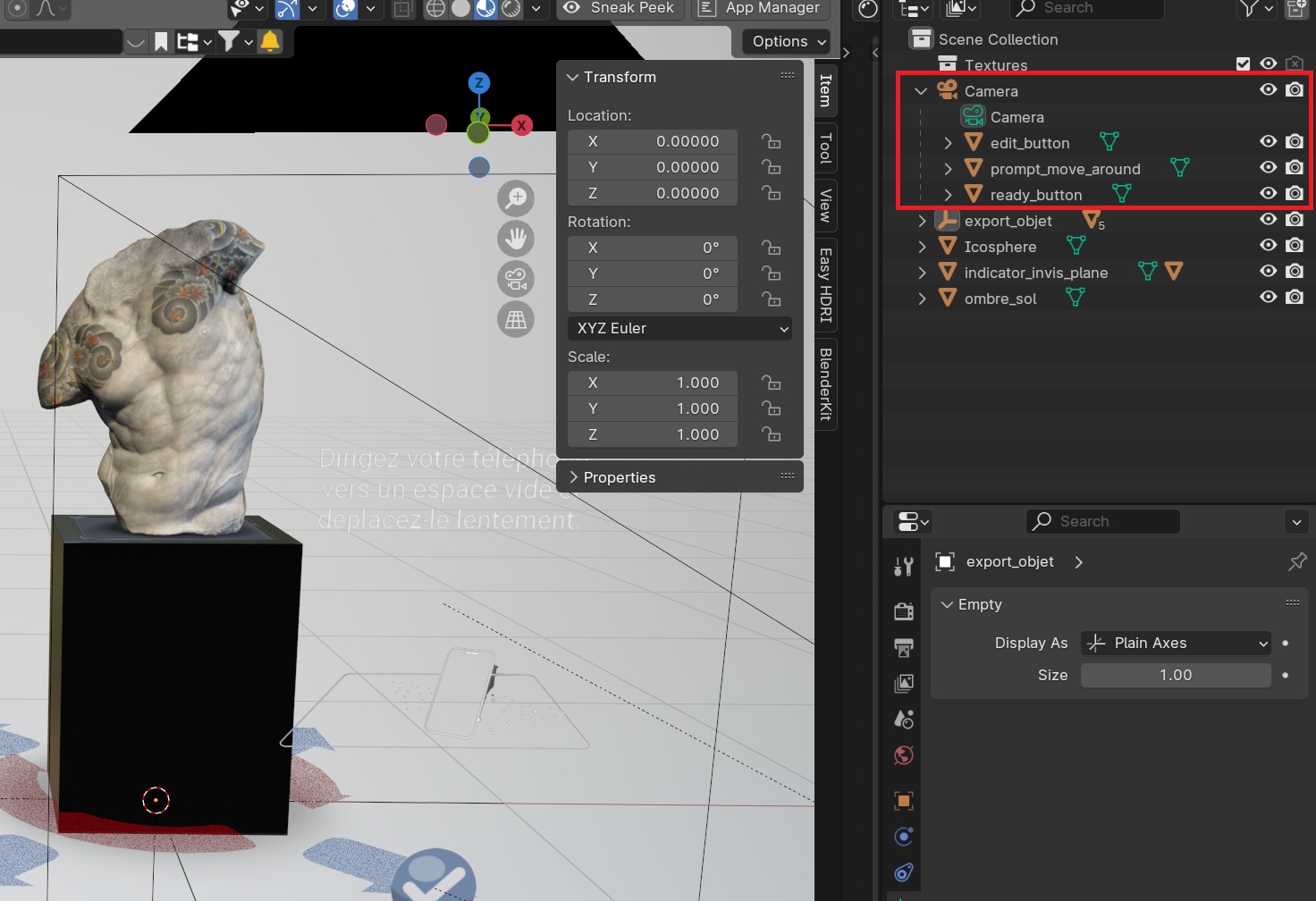

    In the meantime, I have double checked if “ready_button” and “edit_button” were a child of the camera on blender and it is the case (see SC).
    #74018
    I haven’t been able to find where to disable “Fit to canvas” constraint.
    In Blender. Object -> Verge3D settings -> Fit to Camera Edge.
