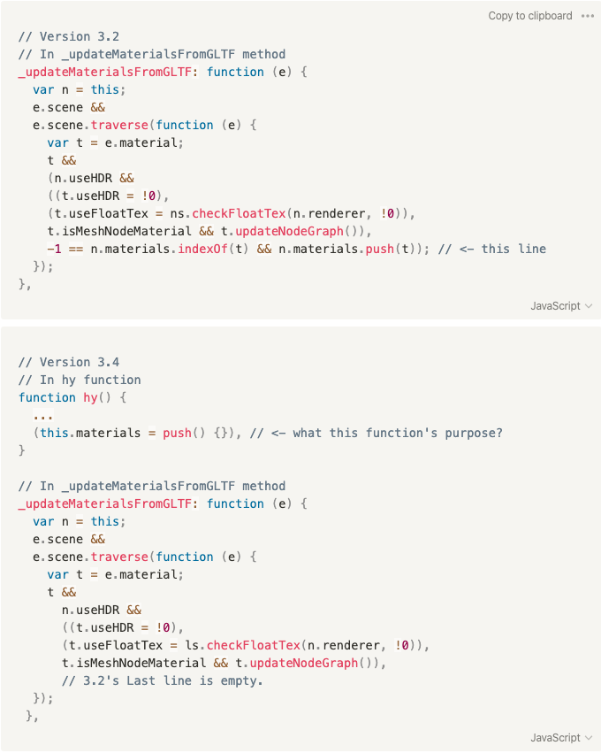

    I currently use Verge3d ver. 3.2 for my project by using javascript API not puzzle. The reason why I still use ver.3.2 is when I tried to migrate to ver. .3.3 I couldn’t do that smoothly since I found problem in app instance. When I open the materials key, there was no array but object.
    I has been waited for the improvement about the problem I mentioned above, but It didn’t go the way I expected even after releasing ver. 3.4.
    I compared code ver.3.2 and 3.4 and fortunately found differences of them. So I wonder if this is bug or your intention.
    Please refer to the attached code.
    If this difference is your intention, I wonder how I can get materials list of ver.3.3. or 3.4. If this is a bug, I hope it will be fixed for the next version.

    That was an intentional change. App.materials was deprecated because it was buggy and didn’t properly track all scene changes, like adding or removing materials. Also, that property wasn’t documented or recommended for use anyway.
    The code that you can see in the 3.4 version is just some backward compatibility measure for old puzzles logic scripts.
    You can get the list of the materials currently used on the scene like this:
    var materials = [];
    app.scene.traverse(function(obj) {
        if (obj.material && materials.indexOf(obj.material) === -1) {
            materials.push(obj.material);
