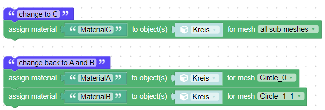

studiogijsCustomer@kdv77kdv Because I don’t see how this is possible. If I assign a material to a single mesh, then subselect a part of the mesh and assign the same material, how then do I differentiate?
Or vice versa, if I have an object with material A and B, and I replace material A with C and B with C, how do I then go back to the object having material A and B?2024-06-19 at 12:35 pm #75032kdv

studiogijsCustomer@kdv77kdv ok, thanks, that looks promising. It’s not clear to me however how I can create a submesh in Blender without assigning more than 1 material to it.

ParticipantIt’s not clear to me however how I can create a submesh in Blender without assigning more than 1 material to it.
Actually it’s not clear to me what are you talking about
You don’t need to create any special meshes or submeshes in Blender. You just create an object, assingn several materials to it as usual and export the scene. The puzzle can replace any material on any object in the scene.

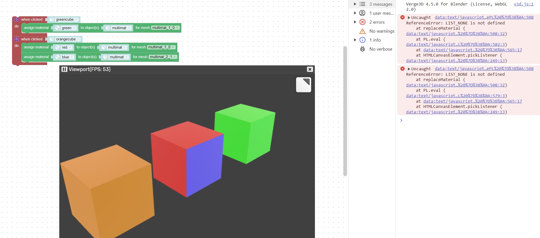

I get an error when trying this. What am I missing?https://cdn.soft8soft.com/AROAJSY2GOEHMOFUVPIOE:606b34768b/my_awesome_app.zip
2024-06-19 at 2:24 pm #75046kdv
ParticipantFor some unknown reason the global variable
LIST_NONEis not defined in your visual_logic.js
Wait a sec, I’ll fix it…
2024-06-19 at 3:07 pm #75049kdv
ParticipantDownload the fix, reload and resave your puzzles.

perfect now, thanks!2024-06-19 at 3:41 pm #75052
