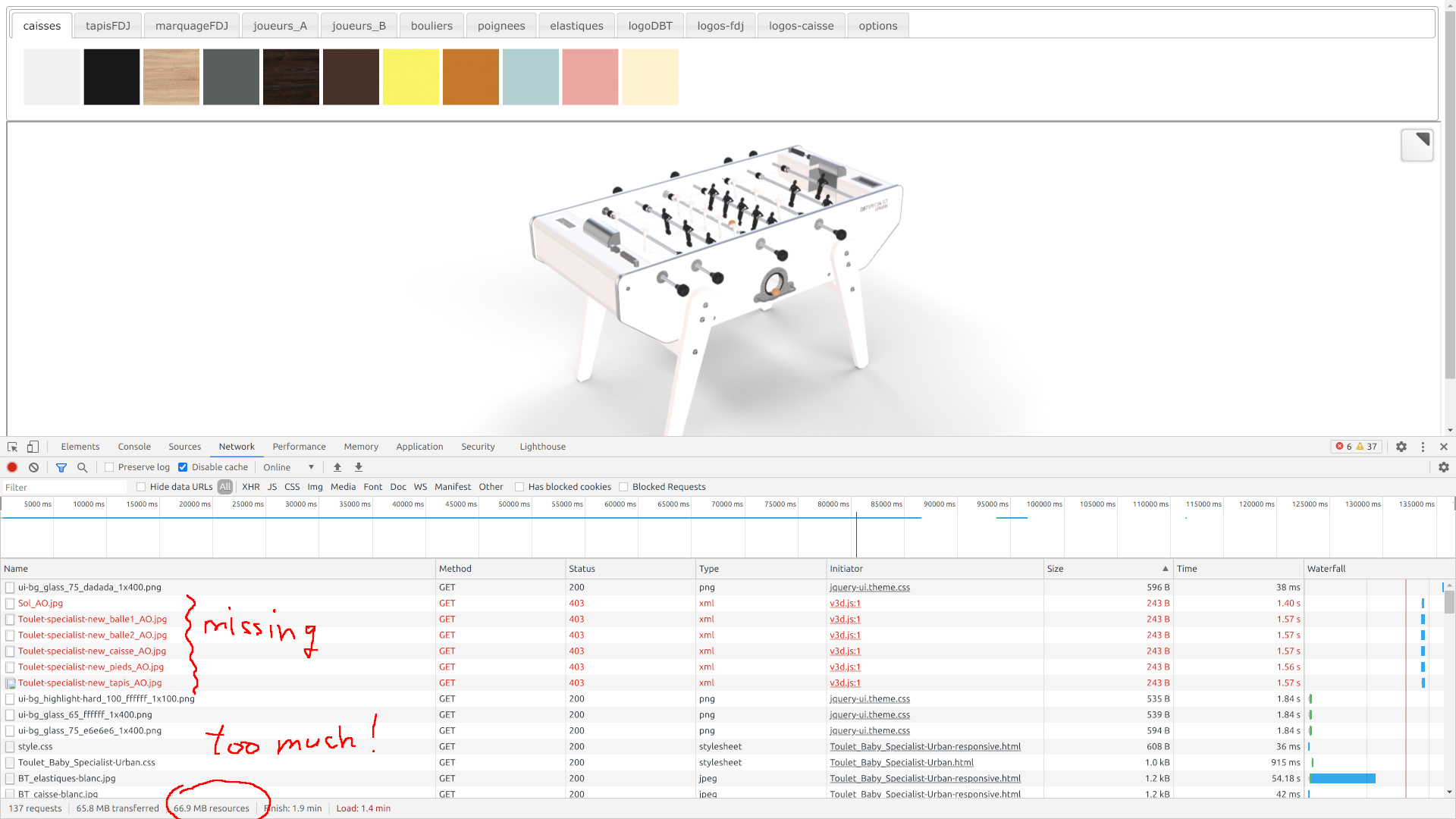

    Then i’ve then made a second project, almost identical, the “local” version is working nice, but when i upload to verge3D cloud, it can’t find maps :
    https://cdn.soft8soft.com/AROAJSY2GOEHMOFUVPIOE:5c0bd316e1/applications/Toulet_Baby_Specialist-Urban/Toulet_Baby_Specialist-Urban-responsive.html
    It should start white, and the wood choice should work, among other ones.

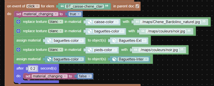

    Both puzzles are the same concerning “caisse”, and puzzles are looking for “./maps/colorXXX.jpg” in both projects.

    may be it is case-sensitive issue again? also some of your textures are too big and overly detailed IMO
    #38813
    NaxosCG
    You are right about case sensitivity, my mistake, again.
    But the shown missing maps should not be needed, as they are no longer used in the 3dsmax’s file, and their name con’t be found in gltf file…

    may be these nodes are hanging somewhere in the materials, and refer to non-existing images?

    You were damn right : as i keep HD versions of my maps, i just forgot to reduce them from 4k to 1k in the application folder…
    Many thanks, again !
