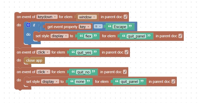

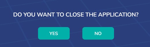

CustomerCongrats! The “close app” and “fullscreen” desktop app were something that I was waiting for, thanks!
Although, there is apparently something wrong with “close app” puzzle. In my app, when the user click “Escape” button on the keyboard, the question appears if he wants to close the app. By clicking “Yes”, the “close app” puzzle should work but it doesn’t. The “No” button works correctly since it closes the HTML div with the question.

Alexander KovelenovStaffAlthough, there is apparently something wrong with “close app” puzzle.
Hi, it appears you’re loading your app in the iframe. Unfortunately, there is no “in parent doc” checker for the “close app” puzzle. We’re going to implement this feature ASAP (possibly in the upcoming bugfix release).

ParticipantHi, it appears you’re loading your app in the iframe. Unfortunately, there is no “in parent doc” checker for the “close app” puzzle.
window.top.close()will work in any case.Puzzles and JS coding. Fast and expensive.

2023-08-02 at 11:27 am #65736Mariusz
CustomerThanks kdv, it worked!
