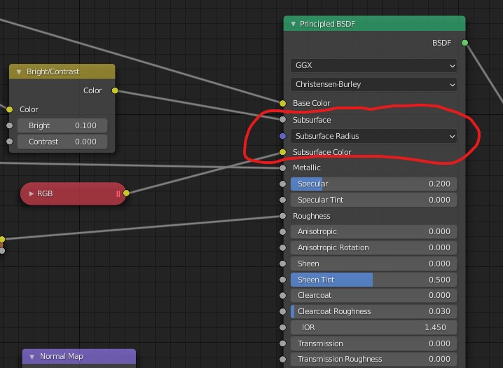

Yuri KovelenovStaffBlender-specific
The Sheen and Sheen Tint inputs are now supported by the Principled BSDF node.
It can be used to realistically render microfiber surfaces such as clothes.
