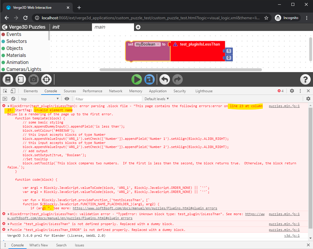

    I was working on a simple custom puzzle today and I encountered an error. In the developer console in the puzzle editor, I received an error that said:
    puzzles.min.js:1 BlockError(xxx/convertListToDictionary): error parsing .block file – “This page contains the following errors:error on line 28 at column 36: StartTag: invalid element name
    Below is a rendering of the page up to the first error.

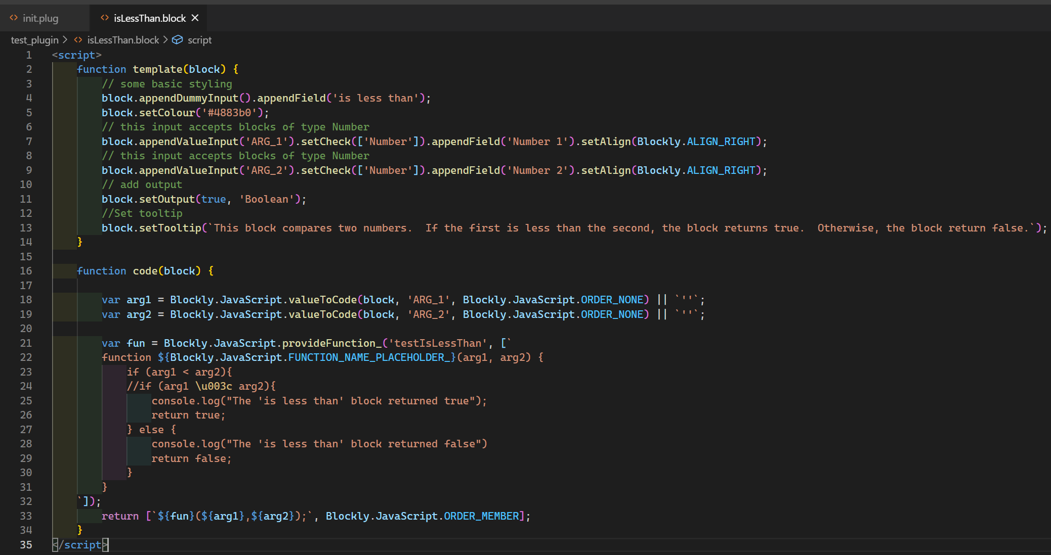

    The invalid element was the less than symbol, “<“. This JavaScript code was in a template literal, per the documentation. Apparently, this symbol causes the parser to fail. I do not think that template literals should have an issue with this symbol. The MDN page for template literals states that template literals support Unicode escape sequences, so I replaced “<” with “\u003c”. This fixed the error. Now this section of code looks something like the code in the attached image.
    This is probably not a bug, but it is an issue to watch for when developing plugins.

    I removed all of the customer information, so I can post it here in the forums. The project is attached here. The code is simple. It compares two number inputs with the less than operator “<“. You can see the error message in the Chrome dev tools console in one of the attached screenshots.
    console parsing error
    Remove line 23 of the ‘isLessThan.block’ file and Uncomment line 24 and the block should work.
    Using the greater than symbol “>” causes a different parser error.
    Using Unicode escapes is a workaround.

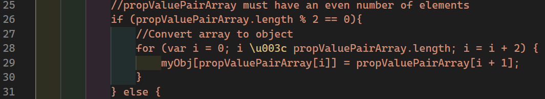

    On a related subject, I would like a design pattern that would allow me to get my code (rather than the API code) out of string literals. VSCode does not apply Intellisense to the code in a string literal. The editor will not match brackets, quote marks, check syntax, etc. The best approach that I found was to first implement and de-bug my code outside of the puzzle system in app.ExternalInterface and then copy the working code into the puzzle system.
