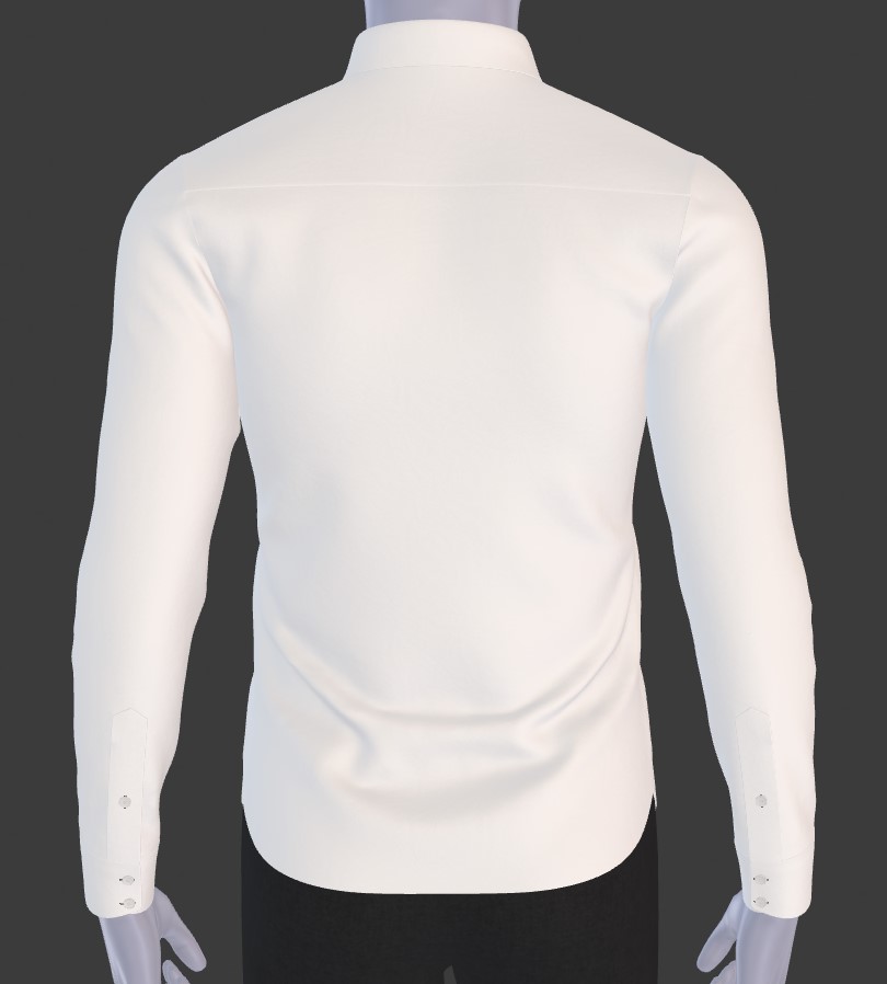

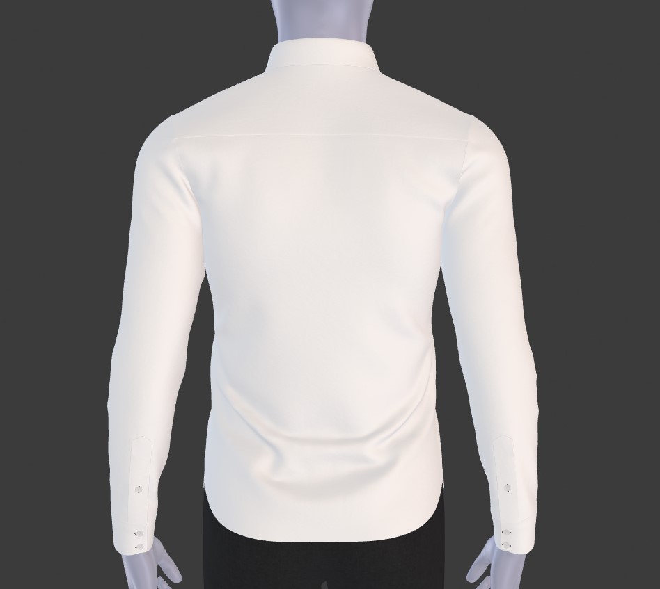

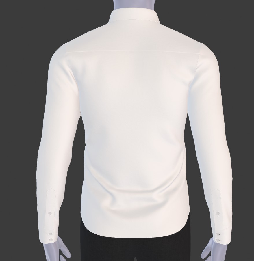

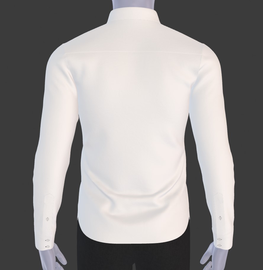

    Hi, really love that sheen has hit the update list but I am having trouble getting it to work.
    Is it supposed to be 0-1 value only? 1 value is usually really low in blender and even tho the slider goes only to 1, you can manually type in higher values like 3 (works great usually) or 10 (exaggerated) for example.
    I have upgraded to 3.6.0 up from 3.4.0 and also updated app I am working on and seem to be getting no results whatsoever.
    Here are some screenshots.
    Edit: I have started a separate topic for this but can’t seem to find the option to delete this post.

    @saranjivac
    The effect should be clearly visible even within [0-1] range. Are you sure you properly updated the engine?
    As for sheen values > 1, we’ll support them in the upcoming bugfix release 3.6.1 (coming later this week).
