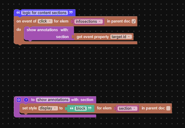

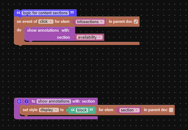

    I’d like to use the target.id of an element in my parent document as an argument in Verge puzzles.
    These puzzles work:
    works
    These do not:
    doesn't work
    When I attempt to replace the “availability” var with my target.id, it no longer works. The target.id I’m clicking in this example is indeed named exactly the same as the var in Verge puzzles, but it seems I’m missing something in the jump from parent doc to local (Verge) doc. Any help would be greatly appreciated.

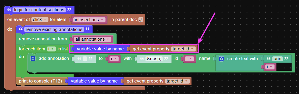

    After digging around a bit more, I realized that the “variable value by name” puzzle may be the answer to my problem. I’ve managed to get this working, but now I’m running into another issue.
    This works:
    works
    While this works for all the elements in my parent HTML doc, when I attempt to use it with an element named “performance” I get unexpected results in the app and console.

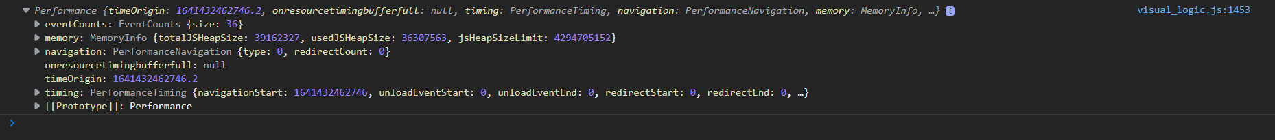

    Normal output to the console with the above puzzle is a list of items from the corresponding variable. However when I attempt to use the “performance” element, I get this:
    console
    Looks like debug info, but I’m not sure where it’s coming from. The obvious workaround is to change my element ID to something other than “performance,” but that would affect a lot of different files on our end. Hoping there is another solution.

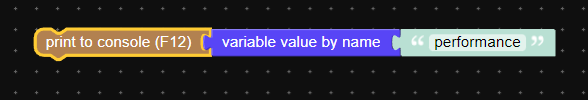

    For clarity, this can be reproduced with the following puzzles:
    puzzles

    Indeed, performance is a built-in global variable
    https://developer.mozilla.org/en-US/docs/Web/API/performance_property
    So when you name an HTML element as “performance”, it conflicts with the existing global variable, and that’s why the puzzle returns the original variable which is of no use for you.

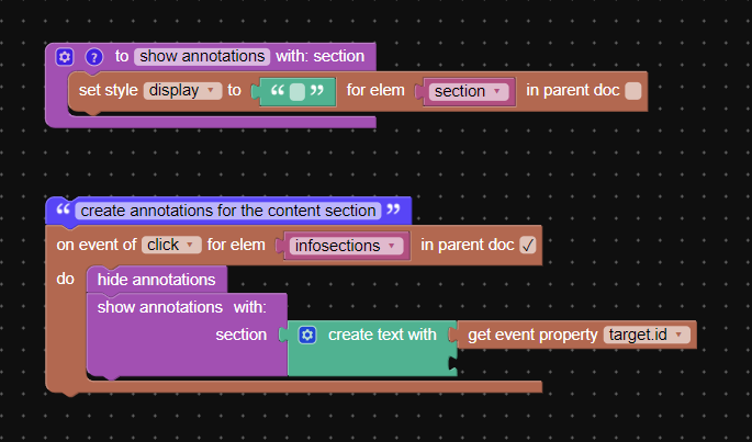

    I suggest you try the following trick. Instead of using that variable value by name puzzle, you just add an empty Text value to the result of the get event property puzzle. See if it helps.
    #48501
    Branden Coker
    Yuri, thanks for the reply. Good to know regarding the built-in performance variable. I had no idea.
    As for adding empty text value to the target.id, what’s the best way to do that? I still need to be able to use this in a for loop puzzle.
    #48505
    you can just use that create text puzzle, with an empty value in the text puzzle
    #48506
    Branden Coker
    Not working for me. I can’t use the text puzzle in the loop input. I also tried reverting back to my original approach at the start of this thread. Couldn’t get this to work by passing the text block to an argument in a procedure either.
