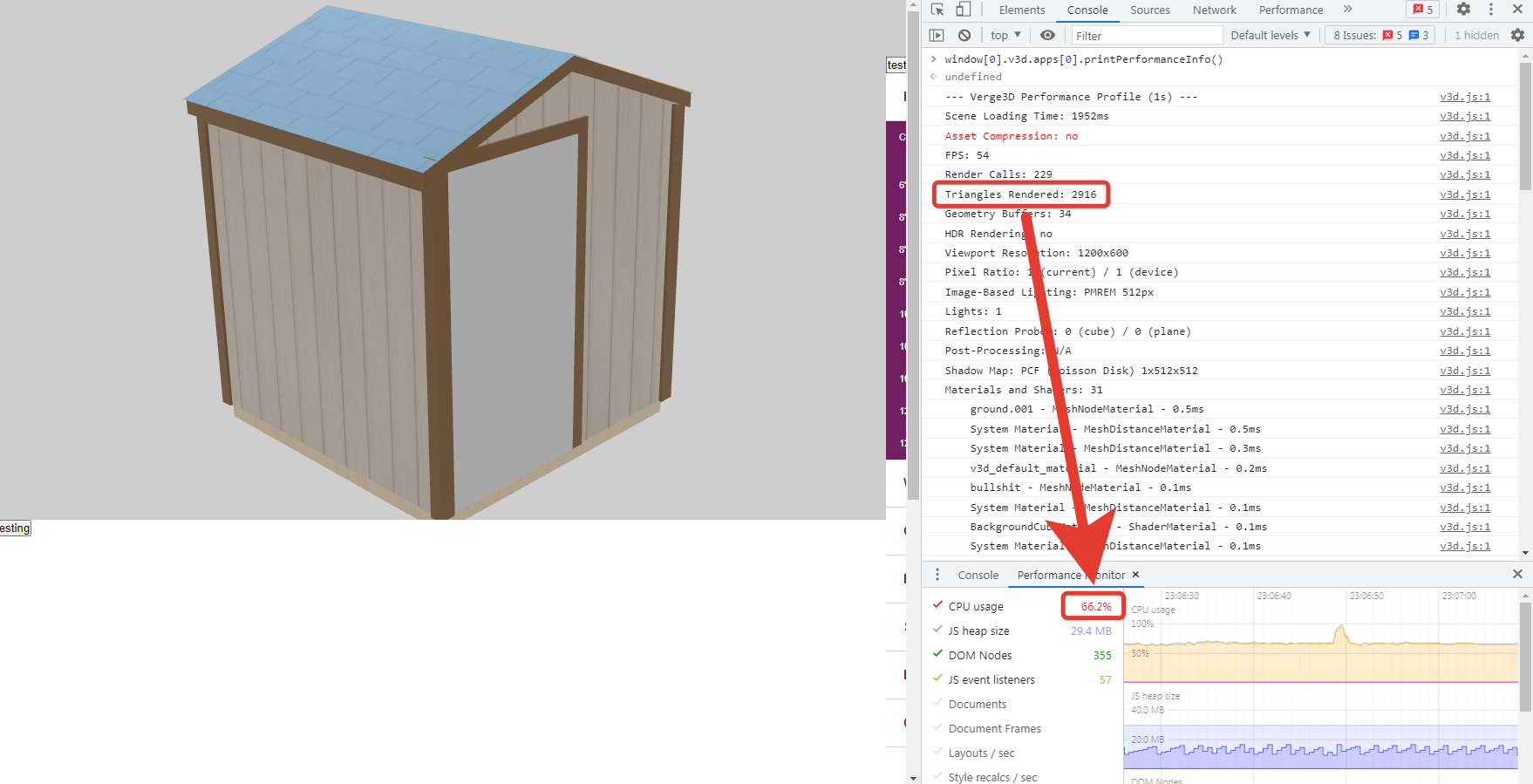

    But I’m curious, is it the PBR’s that look like crap, or what?
    #60161
    I don’t know why your model looks that way. Play with material parameters. What I see is that your site logic won’t work properly with such errors )))

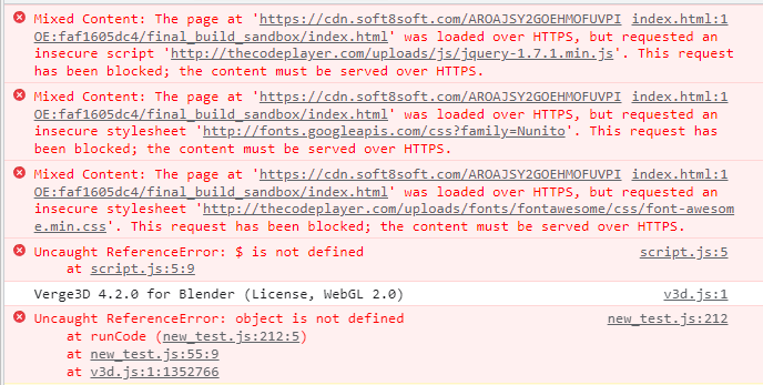

    #60164
    External scripts/files must be requested over HTTPS if the main page is loaded over HTTPS. Otherwise they will be blocked.
    And remove this line from my_test.js
    object.addEventListener("click", puzzles.procedures.addEventListener['lw_2']());
