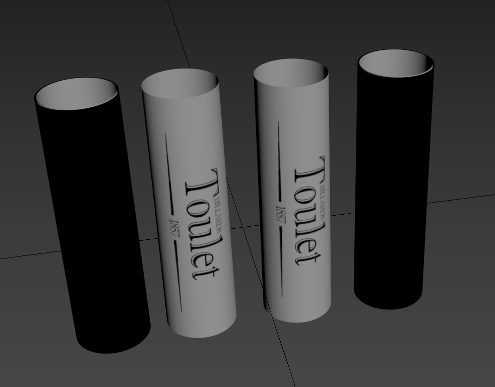

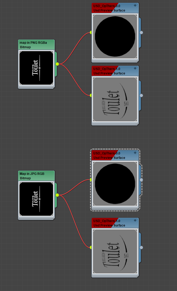

I’m using USD shaders, not for pleasure, but because i need to : i’ll make some AR with iOS compatibility.
I need to put a logo on an object, but with the possibility to change the object’s color with puzzles. As USD does not know about mix / colormap and layered materials, i’ve simply duplicated the part of object, add a “push” modifyer, and tried ti put it in black, with the logo as opacity map.

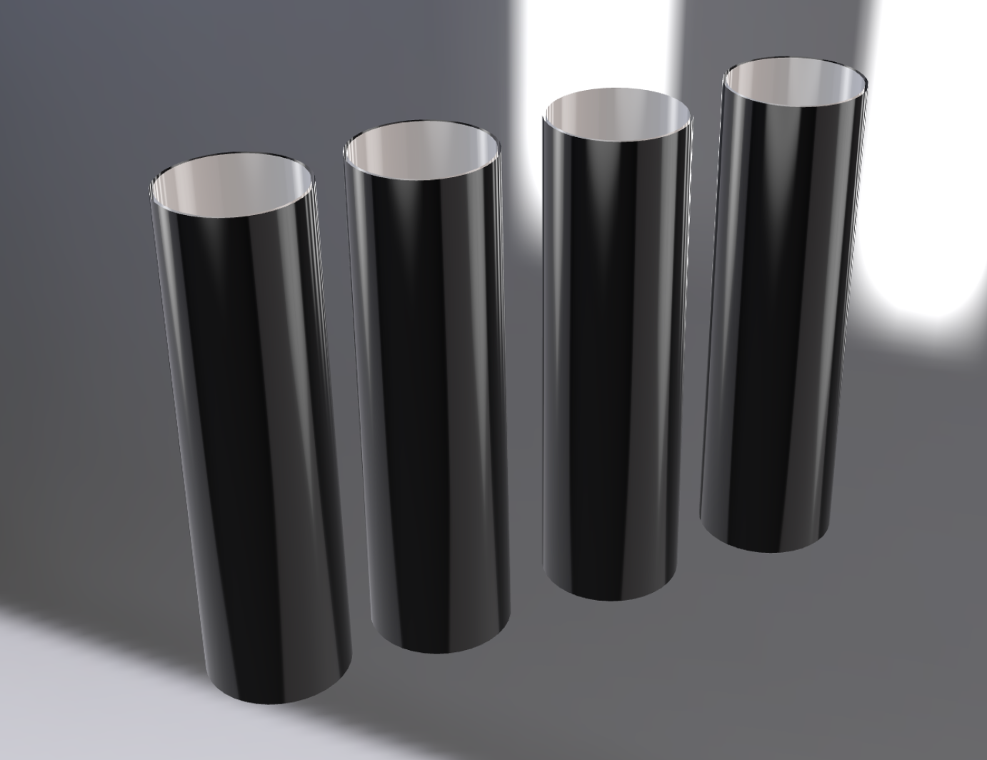

When exported to Verge3D, USD does not recognise opacity map.
See screenshots, and the scene is in zip file with maps to test.I’ve tried in jpg RGB, jpg in greyscale 8b, and also in png RGBa with the logo as alpha : nothing works.

NaxosCGCustomerMany thanks,
In fact, when you connect the png RGBA file into diffuse AND opacity, it works.
Don’t know why, seams not very logical, but ok, it works.

ParticipantRGBA file into diffuse AND opacity, it works.
Don’t know why, seams not very logical, but ok, it works.Why not logical? ))) Standard materials can read opacity only from a diffuse map. U can’t use one texture as a difuse map and another one for opacity. So it’s quite logical that the input is only one.
