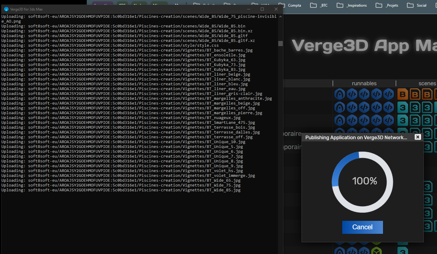

NaxosCGCustomerHello there,
Since the last stable release, when i upload to verge test server, it uploads then get stuck at 100%. So i don’t get the final ok, nor the links to test apps.
Also i’m almost sure some files did not completed right, as i get a different behavior between local and web apps.Any idea ?
Any log to figure it out ?
In the cmd window, it only says what file is uploading, nothing else at the end (when stuck at 100%)I’m on 3dsmax 2024, verge3D 4.5.1.

NaxosCGCustomer[Update] :
I’ve copied the files manually to some web server, and it works : same behaviour between local and server app.Just i can’t send to Soft8soft test server…
2024-02-22 at 3:58 pm #70946kdv
ParticipantThe problem is very old and can happen when you try to upload more than 100mb per project. There are a lot of similar topics on this forum.
2024-02-22 at 4:18 pm #70947
NaxosCGCustomerThe problem is very old and can happen when you try to upload more than 100mb per project. There are a lot of similar topics on this forum.
I understand, but i think all my projects are far above 100mb, and i never had any problem uploading them to Soft8soft server…
I’ll send a zip to Alexander.

NaxosCGCustomerHi,
Could you please export your entire project to ZIP and send us to verify this issue? Might be something to do with file names…Sorry Alexander, again i don’t find where to send files for review…

2024-02-26 at 2:26 pm #71149
NaxosCGCustomerSorry Alexander, again i don’t find where to send files for review…
Please use the contact form to send the link to the ZIP.
Just did it, thanks.

NaxosCGCustomerThanks, I believe we might have something to do about it!
In this zip i forgot to put max files, is that ok without them ?
2024-02-26 at 6:24 pm #71157kdv
ParticipantHow many files in your project are supposed to be uploaded? Did you use so many files before?
2024-02-26 at 6:34 pm #71158
NaxosCGCustomerI guess all of them are needed : 435 files.
And my Billards tables papps are far more : 1583 files"1+1=3... for large values of 1"

Alexander KovelenovStaff2024-02-27 at 1:51 pm #71177
NaxosCGCustomerNo need to max files. Perhaps we might already found the cause of this issue, stay tuned!

2024-03-06 at 1:36 pm #71365
Alexander KovelenovStaffHi, we just release Verge3D 4.6 pre2. It should fix the issue of uploading big projects.
