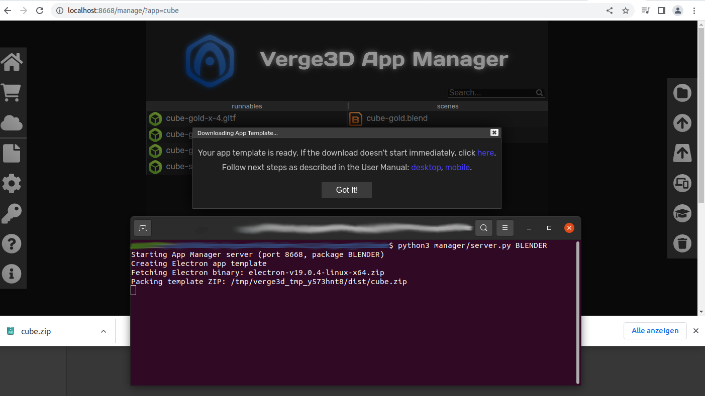

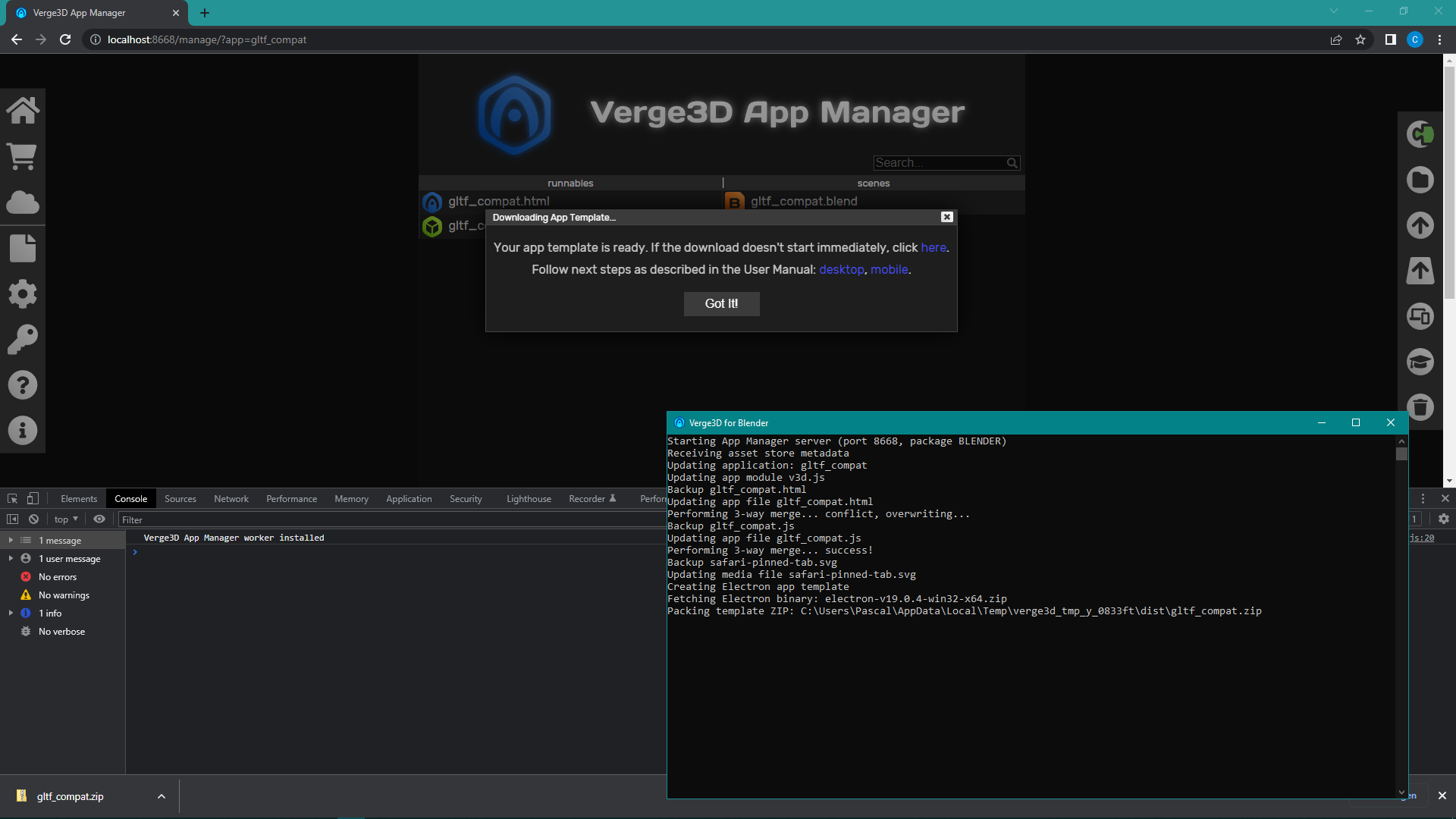

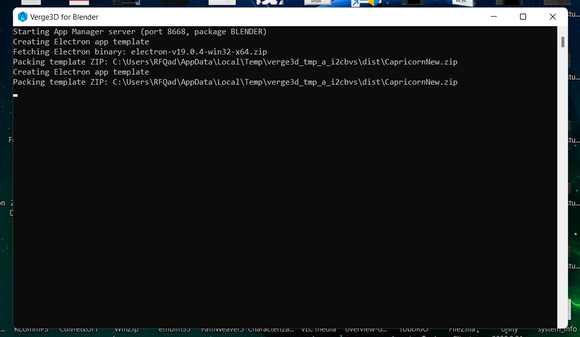

    I just started playing around with the app creation and don’t have much know-how in this field. But I guess, if you want to get good support from someone who knows more, you should try to add all information that is needed. (What OS and system are you running, what target system you are building for, what exact version of Verge3D do you use….)
    What is the output on the console when you run the export? Maybe you get some info there that helps.
    Console

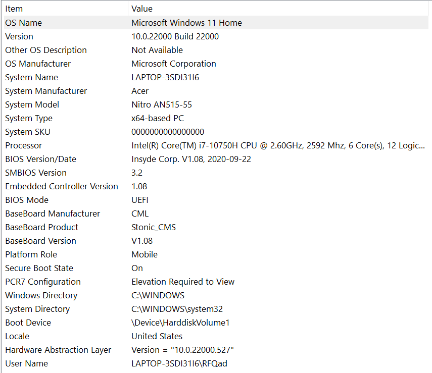

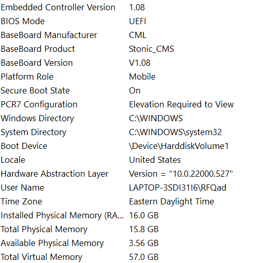

    My system infos: See images attached bellow.
    Target system: Windows (64-bit)
    Verge3D version used: Verge3D 4.0
    Output on the console when I run the export: See images attached bellow.

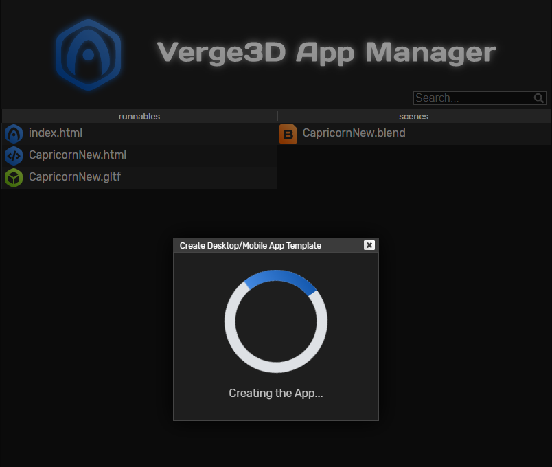

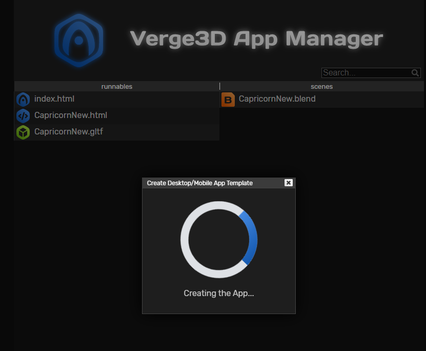

    I attached (bellow) two images corresponding to the windows console and browser console while the app is being created.
    Note: I launched the application creation process last night at 11 PM and it’s still running.
    Thank you for your assistance Pascal.
    #53574
    looks like you have a loop while creating app. but you can see the path where your app was packed…
    #53578
    regisb26
    Hi @kdv77kdv
    You are right, I found the created packed app in the folder. It runs perfectly. I really wonder where a loop can arise from during the app creation process.
    Thank you for the insight!

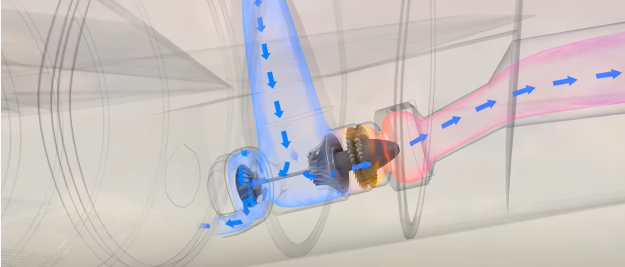

    Here are the kind of animations I would like to have a training for, in Blender.
    I would like to make airflows similar to those seen in the attached images: simple airflows, airflows with arrows inside, multibranch airflows.
    You can see the original animations at:
    timestamp: 3:18-3:27
    timestamp: 10:29-11:00
    11:40-12:06
    Best Regards
