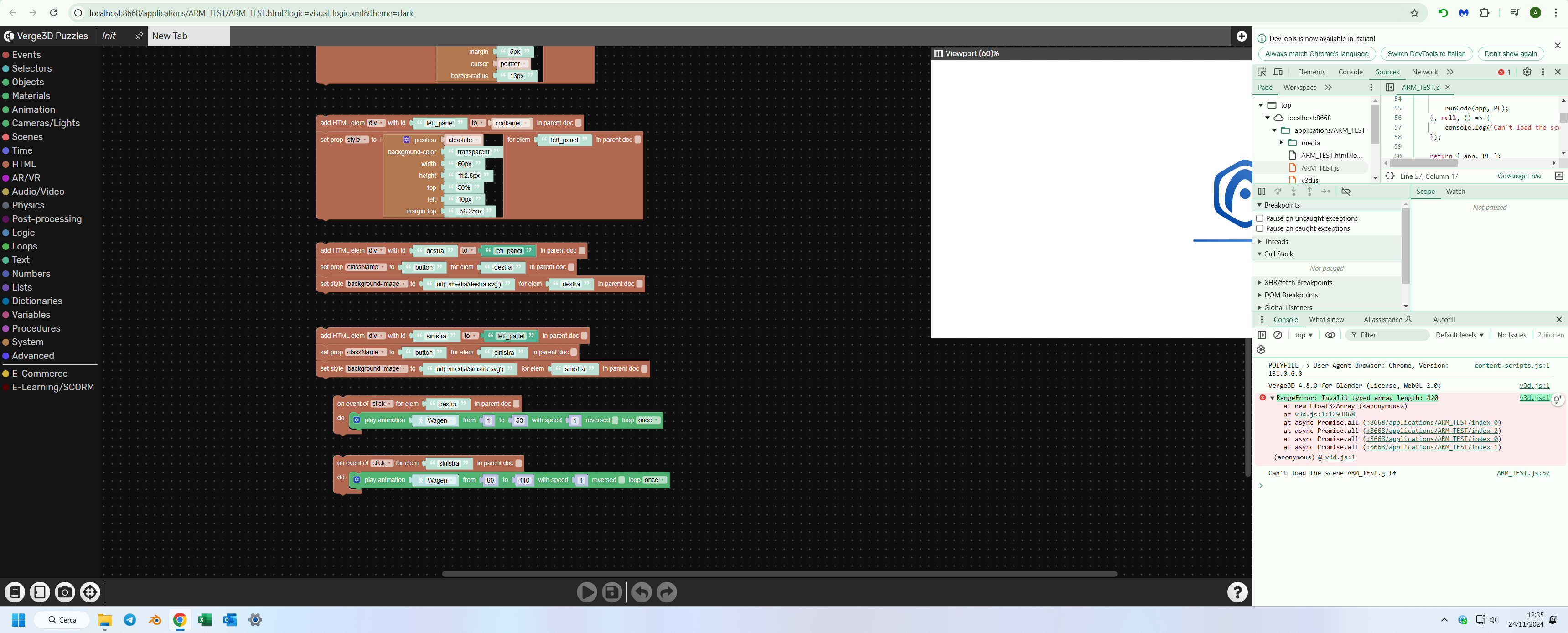

c4ccParticipantSorry for replying to an old thread, but in my case, I use Blender. I replaced a verge3d’s app visual_logic.xml with another and now the loading screen is only 12%?
Error message:
In the past, I could copy/paste visual_logic.xml into another app folder to replace it and it worked.

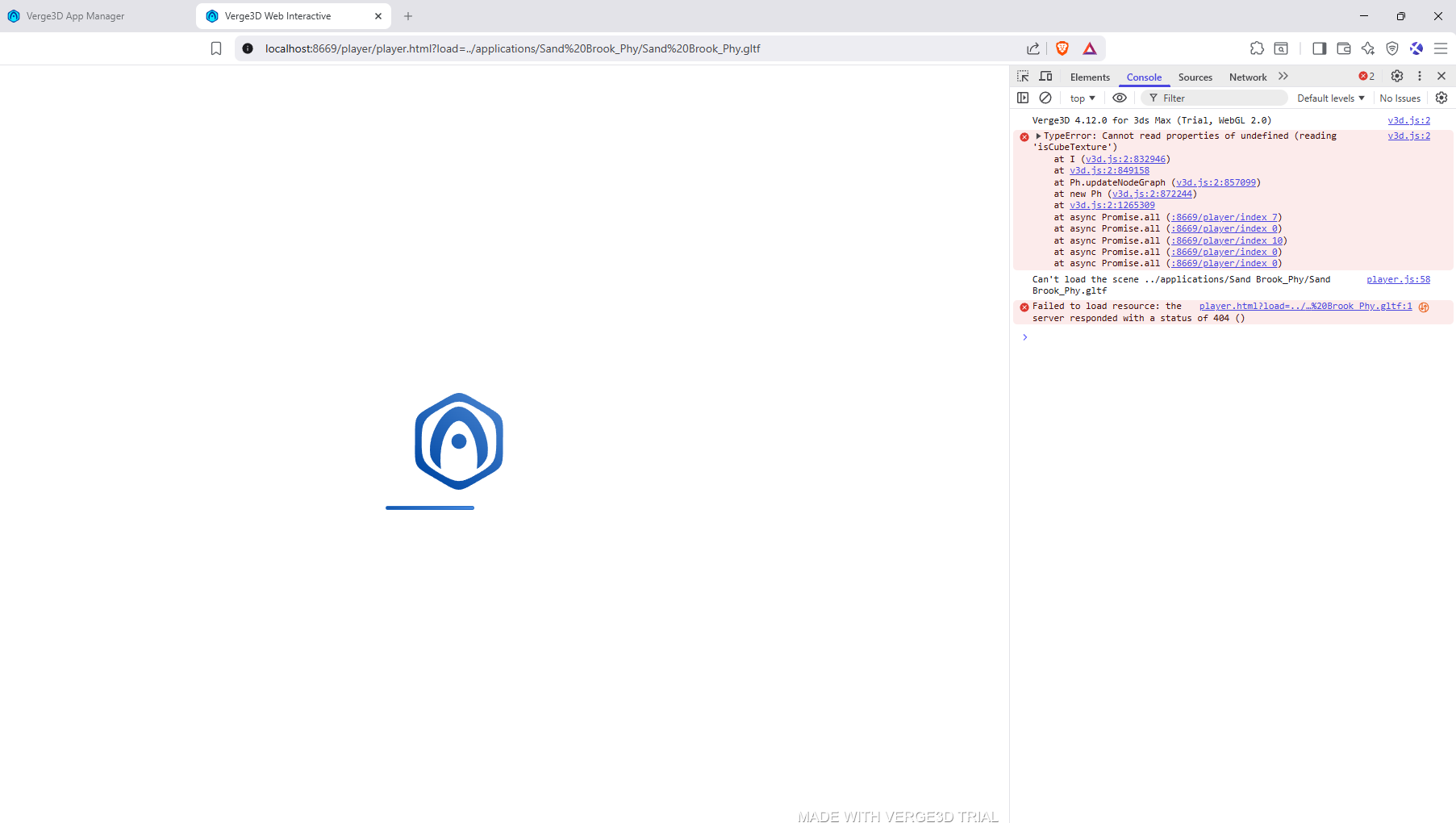

InactiveGood day,
Pls, I have been facing this challenge where my project loads halfway and stops, I have tried everything I can think ofAttachments:
2026-05-09 at 5:12 pm #87168
Alexander KovelenovStaffPls, I have been facing this challenge where my project loads halfway and stops, I have tried everything I can think of
