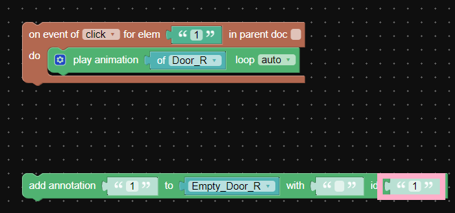

    So, i try create annotation and add click trigger on it, but it won’t work and at the selector the M (which annotation) turn red. what’s wrong with my puzzle and how to fix it?

    so, how to make the annotation ID can be HTML event “target”?
    trying something like this isn’t working.

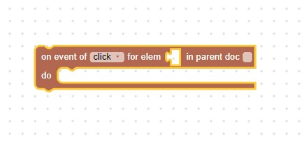

    Instead of When Clicked you need to use HTML puzzle Event of (click) with an ID of the element. This one.

    hasanyluthfi
    annotation
    thanks for the answer. so, how to make the annotation ID can be HTML event “target”? trying something like this isn’t working.
    yea i’m also trying that, but when insert the ID use same id as annotation (1) it’s still unclickable.
    • This reply was modified 1 year, 11 months ago by hasanyluthfi.
    #32834
    Try to put Event on under the Add Annotation puzzle.
    #32835
    hasanyluthfi
    ah ok, thanks alot it works :good:
