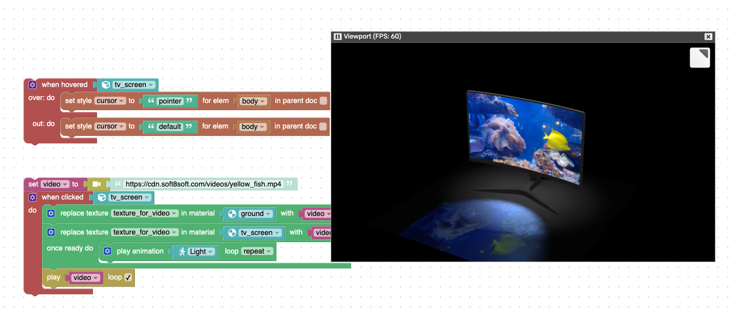

    #52211
    The puzzles provided will produce the same effect as seen on https://www.shadertoy.com/view/wlSfW1
    The lighting effects shown in https://exp-infinite-passerella.lusion.co/ are completely different and use a combination of fog, bloom and depth of field to get the effect. When I have time I will create a demo and send code.
