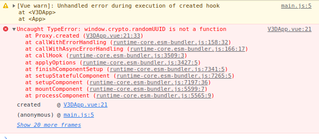

    I have followed the steps published in the official web page abour creating an app with verge3D and vue.js. Everything seemed to be working fine but when I try to access the app from my IP instead of “localhost” it doesn’t work. The browser console shows the message in the image attached.
    Why is this happening? am I missing something? What can I do to solve it?

    Hi xsehio,
    Solution is that instead of HTTP you should use HTTPS. This is because window.crypto.randomUUID only runs when your domain is localhost, or when the request is via HTTPS.
