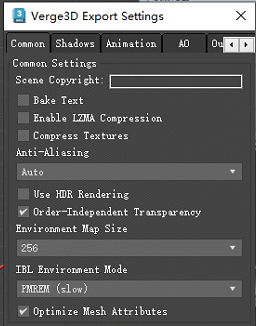

ParticipantTry Coverage or move objects a little far away if you insist on Blend. Or try the render order independent transparency if you use Verge3D 4.3.0+
2023-06-04 at 10:06 am #64356yueyan231881306
ParticipantHello, kdv, verge3d is 4.3.0. How do you adjust the rendering order and independent transparency? Where is it?
2023-06-04 at 10:13 am #64357kdv
ParticipantSomewhere in the Verge 3D export settings.
2023-06-04 at 10:24 am #64358yueyan231881306
ParticipantHere?
2023-06-04 at 10:28 am #64360yueyan231881306

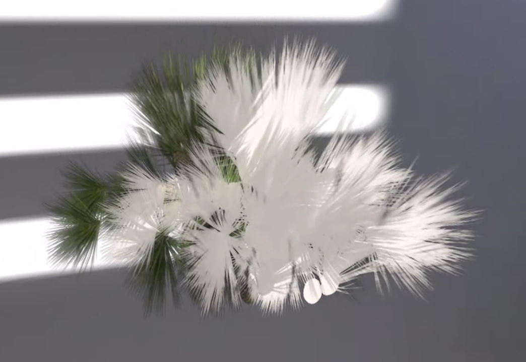

ParticipantHello, KDV, this seems to solve the problem, but areas that should not have been transparent are also transparent.
2023-06-04 at 12:04 pm #64362kdv
Participantthat should not have been transparent are also transparent.
That’s how the render order independent transparency works. Transparent materials are never fully opaque.
You have no other options to solve this problems. One more way: do not use parallel planes. That’s all. Nothing else to discuss.

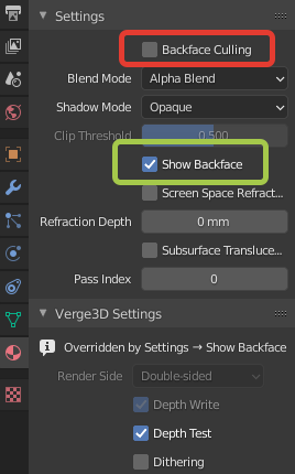

2023-06-10 at 5:32 pm #64490kdv
ParticipantThe issue can be eliminated this way
OIT is not needed
Looks exactly like in Blender’s EEVEE
