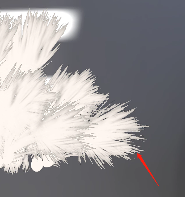

ParticipantWhen the model is close,Changing the viewing angle can cause this problem,May I ask how to solve it?

Participant2023-06-04 at 6:13 am #64344yueyan231881306
ParticipantI shared a GIF on the webpage and helped me take a look. In fact, two objects with transparent textures are close together, and when rotating at an angle, there may be issues with the display.

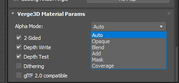

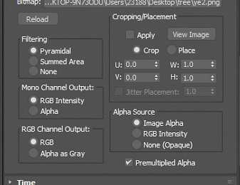

2023-06-04 at 9:36 am #64348yueyan231881306
ParticipantHello, kdv, is this what you’re talking about in 3dsmax? I didn’t see the alpha clip.
2023-06-04 at 9:40 am #64351kdv
ParticipantMask

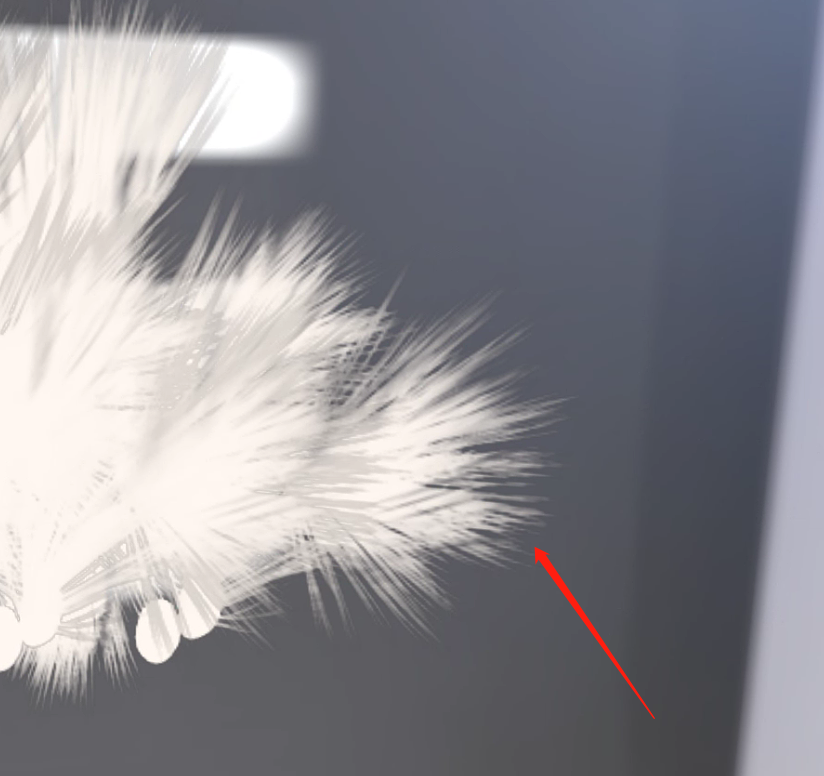

2023-06-04 at 9:45 am #64352yueyan231881306
ParticipantHello, KDV, although this solves the problem, the effect I need is gone. I need a transparent gradient on the edges. After changing to mask, the edges become too hard.
