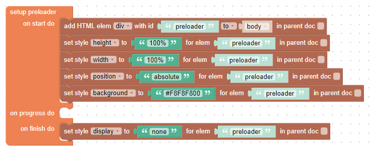

Dario2022-11-24 at 8:13 am #58392kdv
Participant<div id="background" style="width: 100%; height: 100%; position: absolute; background: #F8F8F800;"></div>Puzzles and JS coding. Fast and expensive.
2022-11-24 at 12:27 pm #58405Dario van Houwelingen
CustomerThanks a lot for your reply. Where do I add this, to the CSS file or HTML file? I’m not at all familiar with coding…
2022-11-24 at 12:43 pm #58406kdv
Participanthtml
2022-11-24 at 1:22 pm #58410Dario van Houwelingen
CustomerGreat thanks! The preloader is now transparent.
