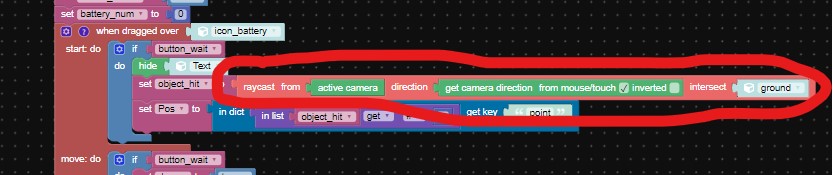

    No problem on pc, but on mobile its working at first start test but stop as project advance, try to move it to the new project with just bring gltf (3dsmax export) and visual logic.xml, still not working, any idea?

    I believe its because conflicted with raycast puzzles, when i disable the raycast puzzles the toggle fullscreen works, when i enable it again the toggle fullscreen doesnt works. For the solution i replace toggle fullscreen function with puzzles with html button created since i also want to customize the button..
