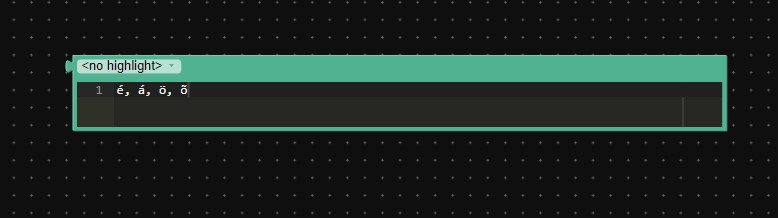

    Hello, everyone!
    I working on a website where we use a lot of accents like é, á, ö, õ .. I also noticed that for the attributes I couldn’t use space between words, I need “-“, “_” or something. It’s a little look weird in terms of design on the front-end. On the custom attributes, I can add different slugs, but I use an import plugin for the variations, so I can’t use the custom attributes option.
    Is there any trick to solve this?
    Thank you in advance!
    Best regards,

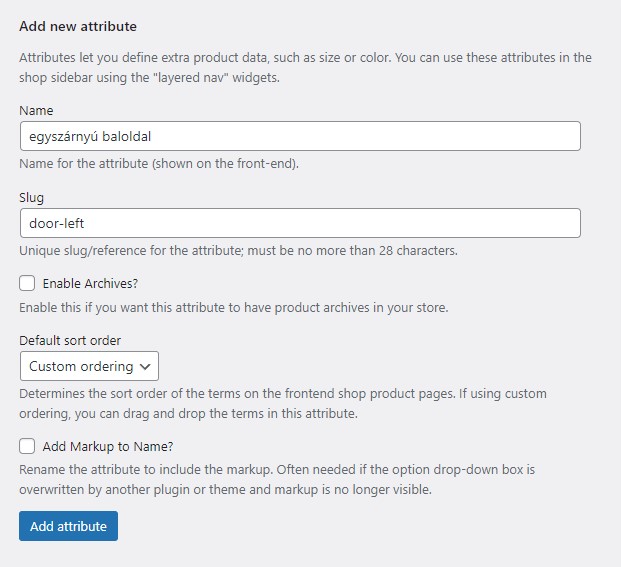

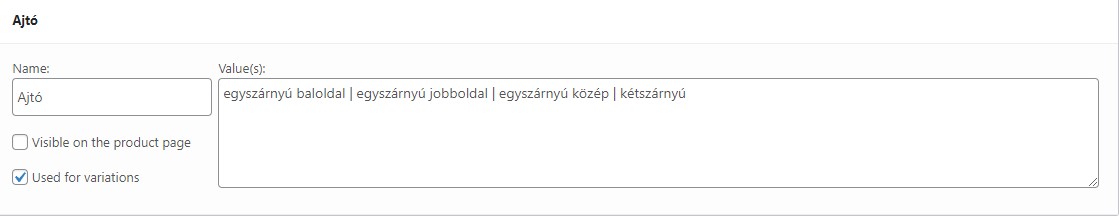

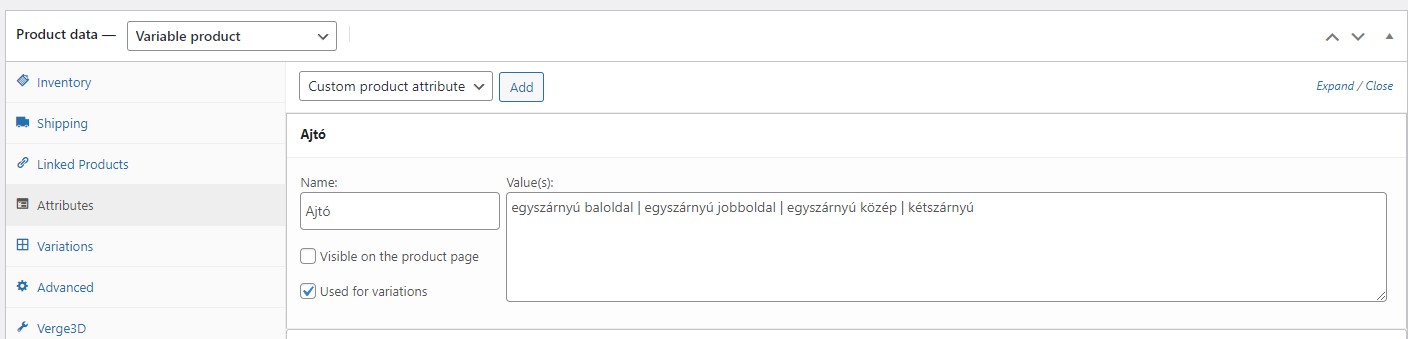

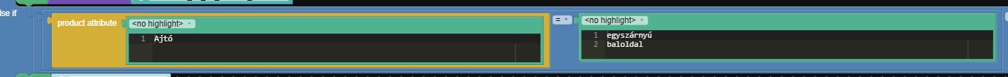

    I have tried, but no luck. I attached screenshots but looks like with this type of text, they are not communicating with each other, or should be?
    #51011
    So basically you mean you can create attributes with accents in WooCommerce and they correctly shown on the product page, but you can’t select these in Puzzles?
    #51012
    peet
    Hello Alexander,
    Yes, exactly. As you can see in the attached images, I can create attributes with two options, one of the options allows me to add “slugs” and this option is Ok, because the text puzzle sees the “slug” version, work perfectly, but if I add attributes in the other way, please, see other attached image, there is no option for “slugs” so I need to use the same text on the puzzles. In Woocommerce I see correctly the attributes, I can write anything, but the puzzle does not see if it contains accent or not in-line text. I have a lot of variations so I need to import attributes from CSV and it creates attributes in a second way, unfortunately, without slugs.
