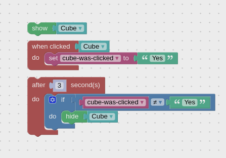

    With puzzles I tried to find the way to having the following logic, and I didn’t:
    Show an object; if after, say 5 seconds, it hasn’t been clicked then, with a timer, hide it and show a second object, etc.
    And if it has been clicked then bypass the timer.
    Kind of a switch between an “if not clicked” and a timer; or the implementation of an “if not clicked after x seconds” puzzle or combination of puzzles.
    Because to having the two parallel flows shock each other: the “after x seconds do” WITH the “when clicked do”.
    It seems that the combination “if > not” puzzles cannot be connected with the “When clicked” puzzle; if else don’t seem to be connectable either within this kind of desired alternative.

    You can achieve the desired behavior with a variable which you can set if an object was clicked, and check inside your timeout block.
    See the attached example.
    Regarding the other usability requests – they all make sense. Can you describe your item 3 issue in more details or attach a screenshot of the problem?

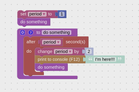

    Hello Yuri!
    Please, can we either loop a timer or increment time with puzzles?
    Or implement something as: “After 5 sec” OR “After 30 sec” OR…?
    NewFake :)
    #2806
    like this? :)

    Hi Yuri!
    Thank you; I probably wasn’t clear enough, but your answer helped me a lot and put me on the right track.
    Even if a visual scripting helps a lot its logic has to be caught :)
    NewFake :)
