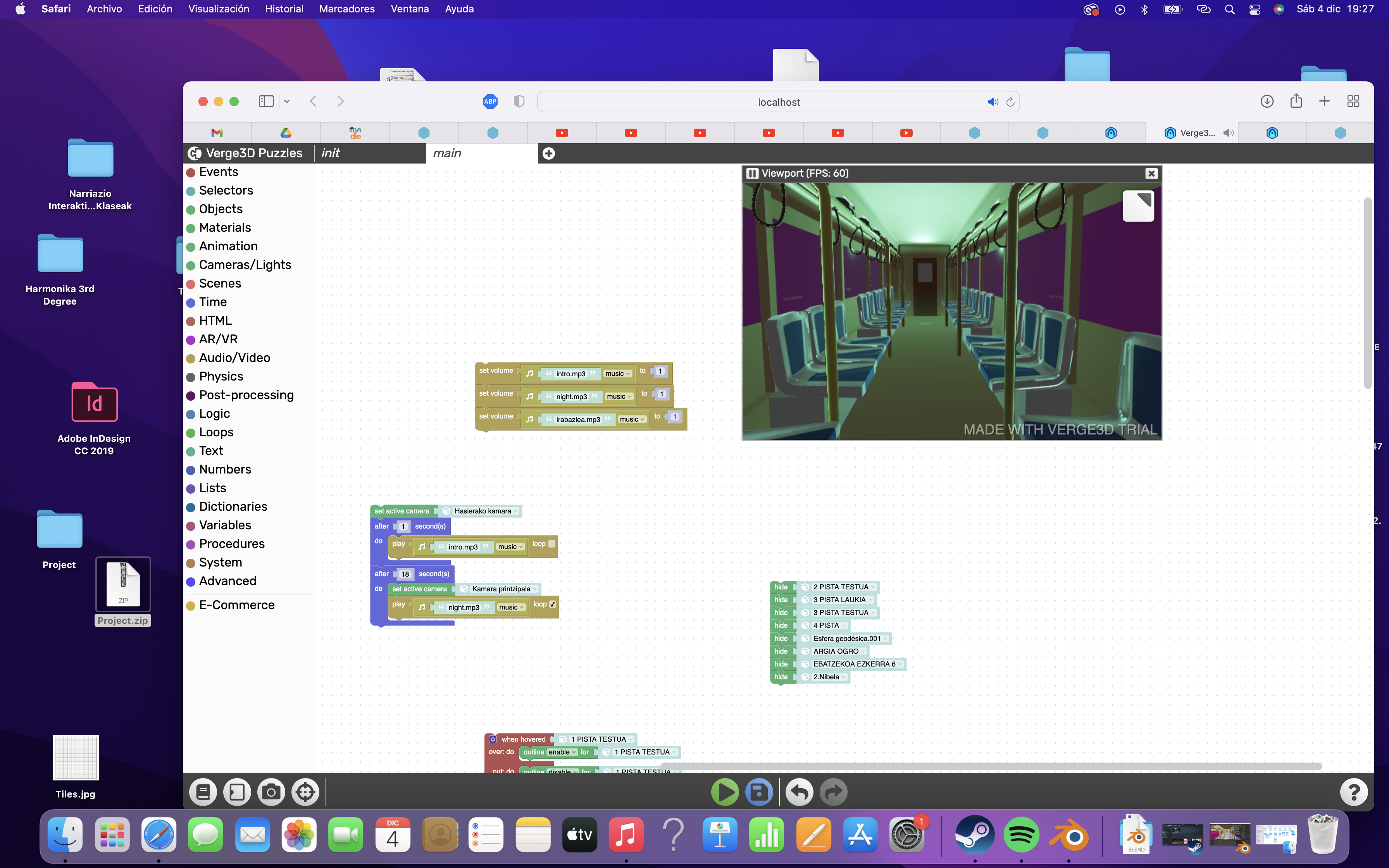

    Hi. I have put sounds to start at the beginning of the game I am making. With the Puzzle Editor it works just well, but when I upload it to the web or even use the Runnable version the sounds just don’t run, can you help me?

    Hi, I actually tried that before (because checked that solution in the forum), but still not fixing the problem.
    I attach the project with that Initialitation button (the box that appears in front of the camera). Check it out please, this problem is driving me crazy!

    #47574
    enekio
    I tried the scene you attach but can’t listen to the sound (there is a sound 1 sec after the button is pressed). Everything works except for the sound actually.
    #47711
    enekio
    Hi again, checked in another computer and the sound worked. Could it have something to do with having a Mac? (being the Mac the system where it doesn’t work and PC where it does?). If that so, is there a simple solution to this?
