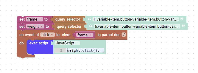

    Hi, I am close to finishing a woocommerce 3D configurator for a customer but we realized there are some dependancies (when certain options are picked, others are then hidden and have to default to something else).
    We resolved the hiding part within UI but the other part is the issue.
    Ideally the woocommerce part of Verge3D would have some sort of “Set” option, where we could set a product attribute to a specific value but in it’s absence I am trying to resolve it via a java script.
    The solution in the attachment should work in theory, but I believe perhaps the issue is that the .click() function does not know how to from iFrame to parent files?
    I am somewhat familiar with programming (was schooled for it but never actually practiced it after).
    #60873
    First:
    VARS.weight.click();
    Second:
    Your variables are not HTML elements.
    Use JS

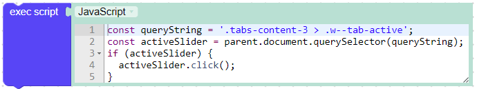

    #60878
    saranjivac
    I figured it out, this seems to work, and explains why the variables weren’t HTML elements.
