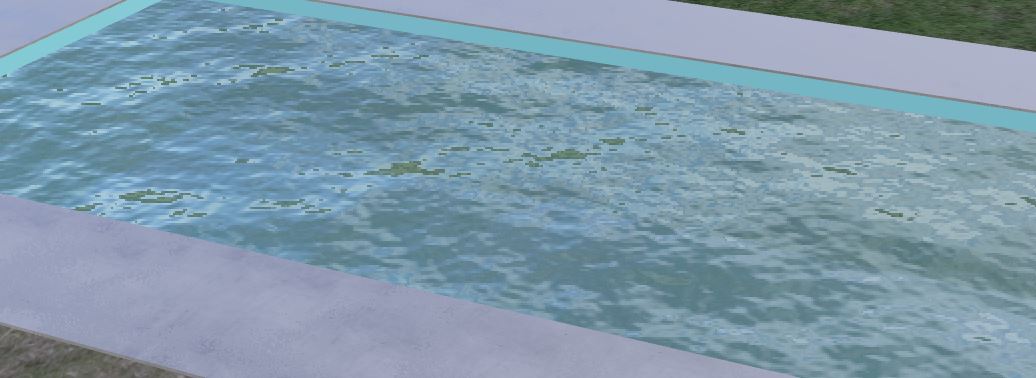

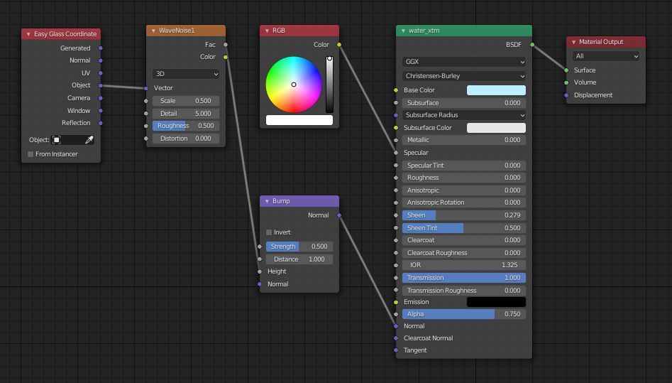

    I tried to make a simple water shader as you can see in the first picture.
    But unfortunately in Verge the water is displayed as in the second image.
    Does anyone have a solution for this or a good tutorial?
    Thanks!

    I think your shader has no problem.
    It may be an HDR highlight clipping. you can try “Light Probe(fast)” setting in “IBL Environment Mode” in Verge3D Settings.

    It’s because of bump node, try to bake your texture to a nomral map to get smooth result.
