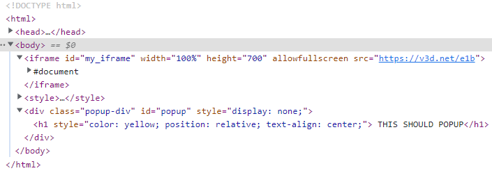

    #59399
    rasmusroerbaek
    You guys make it seem so easy :unsure:
    What am I doing wrong – with a new project:
    First (for testing):
    Setting display to: block,
    block
    I’ll get this:
    shown
    So far, so good. Then – setting display: none
    none
    I’ll get this:
    hidden
    Cool – then setting the puzzle:
    puzzle
    Save, then run the HTML from app manager.
    Clicking the cube and nothing shows up. :cry:
    Am I missing something?

    #59405
    you have a wrong iframe src in Home.html
    replace https://v3d.net/e1b with Html_test.html
    #59407
    rasmusroerbaek
    can u elaborate on this kdv? how can I fix it?
    #59408
    rasmusroerbaek
    whoops, did not see the last part, I’ll try it
    #59409
    rasmusroerbaek
    It’s working!!! thank u so much. :yahoo: :heart:
