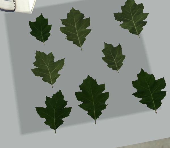

    I have a plane with a leaf(RGBA) png applied. I can see that the shadows are respecting the alpha in blender’s evee render. Verge 3d however fails to read alpha while casting shadows and instead casts a shadow of the entire plane. See image attached. Is that not supported or am I doing something wrong here?
    It’s not supported.
