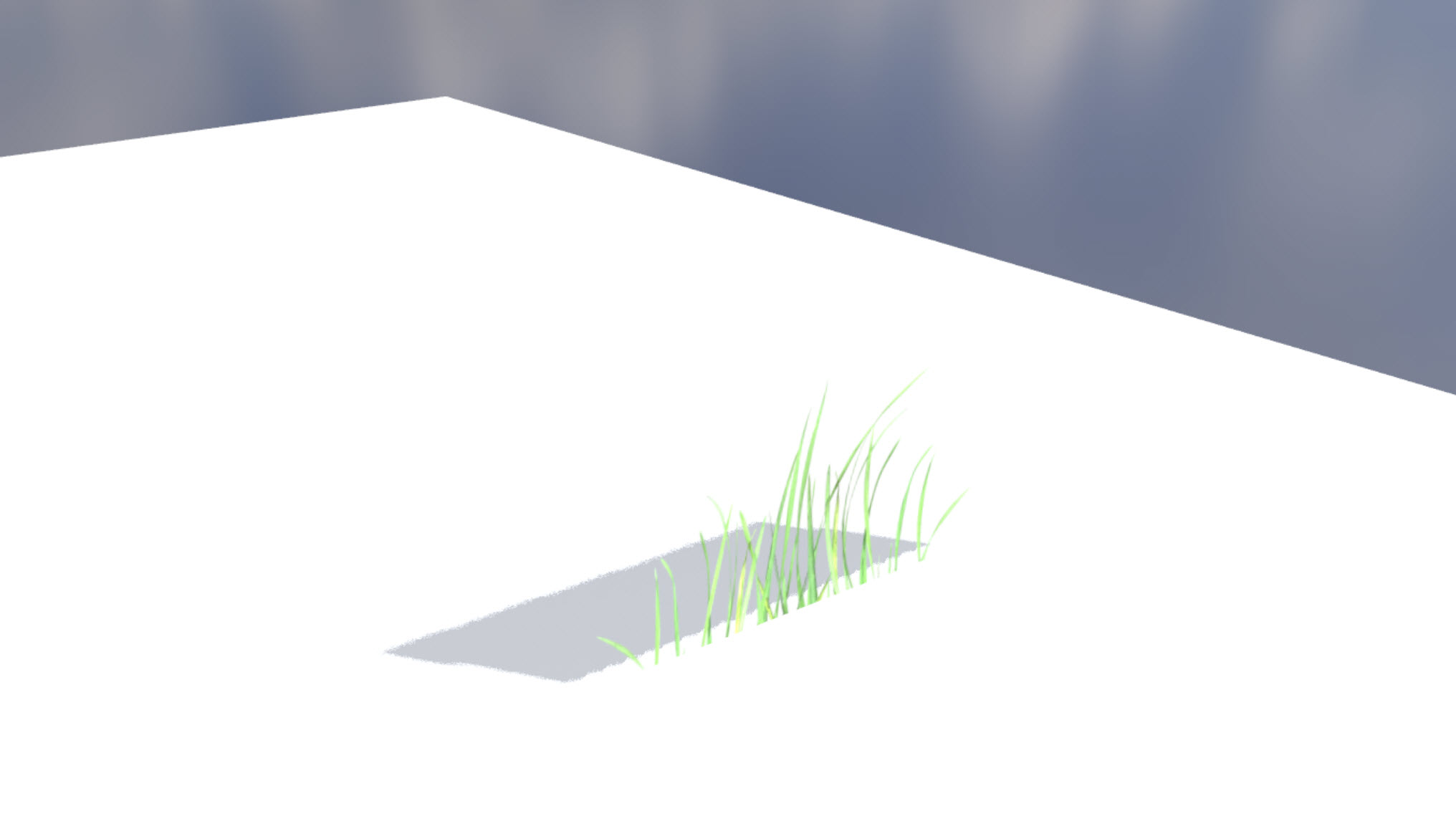

    I’m trying to planes with cutout materials. So for example, this grass is a plane with a texture on it. I’m trying to get the shadow to be that of the grass, rather than that of the entire plane.

    For example, I have a single quad that I’ve applied a cutout material to in order to make it look like grass. When it cast a shadow, I would expect it to cast the shadow of the grass (since it’s a mask) but as you can see in the example, it is only casting the shadow of the full quad.
