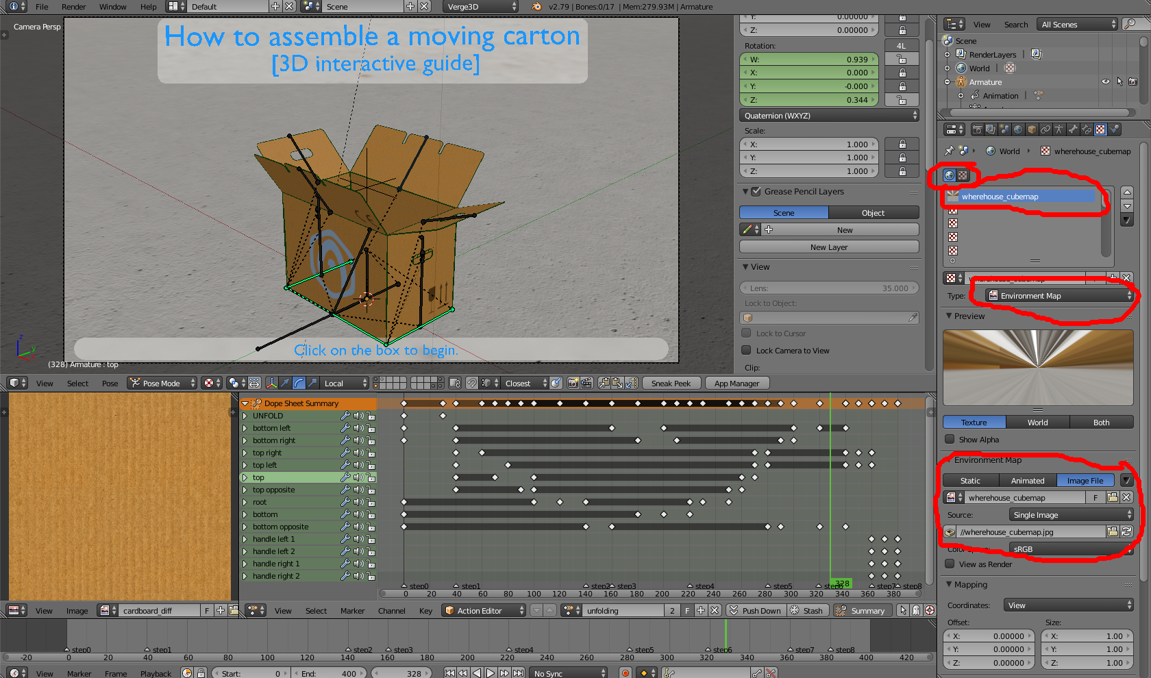

Mikhail LuzyaninStaffIn Blender/V3D, i don’t find the way for setting a cubemap environment, how it can be done with V3D please (inside Blender) ?
You can find how to setup a cubemap in one of our example inside SDK. For example in the e_learing application. Here’s a screenshot from that application, pay attention to settings that highlighted with red.
