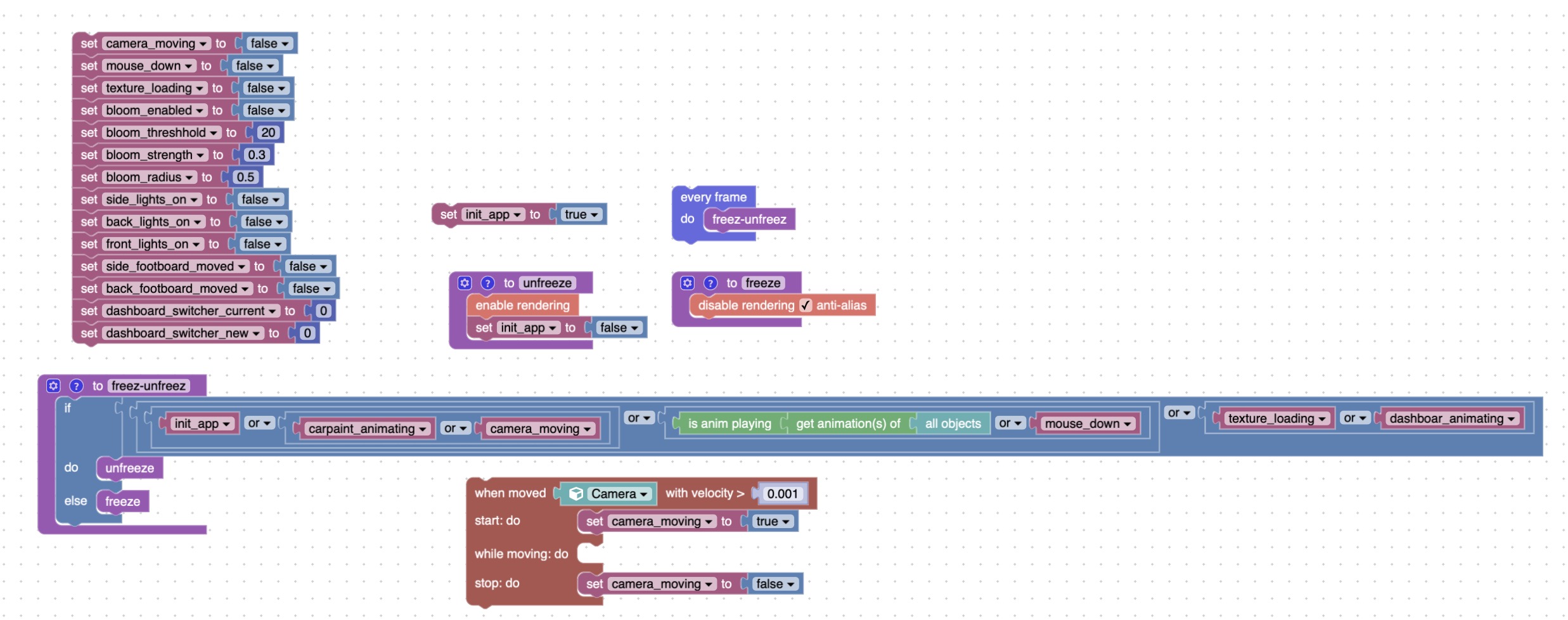

    I am struggling with freeze unfreeze function.
    my goal is disable antialiasing when camera rotating, moving and re enable antialiasing when stop. this works well in scooter demo project. but I could not represent. attached capture puzzle is my suspected puzzles to enable this freeze-unfreeze function. Is this parts are all I need or another I missed exist?
    Any suggestion would be appreciates.

    It’s depends on what action performed in the app. Difficult to say what need to add without knowing what hapening in the app.

    PhotonCraft
    Thanks for reply.
    I need to look more into another linked puzzles.
    To make sure, I want move fast with low quality render,
    and when stop to move, high quality render doing process.
    thanks

    It’s not a high quality rendering. It’s just the same rendering with the SSAA pass enabled. By default MSAA is used.

    PhotonCraft
    ah.. I clearly understand in AA display working by freeze, unfreeze routine now.
    Thanks for explain.
