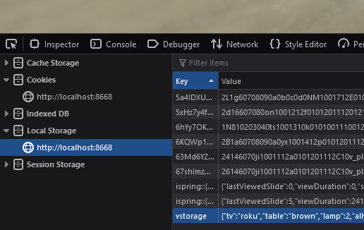

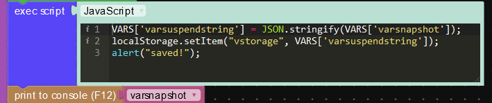

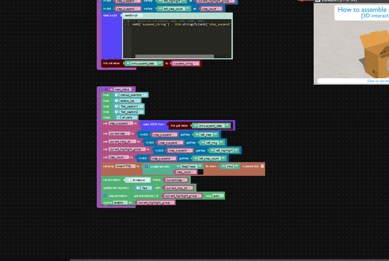

So far, what I have managed to put together is a simple scheme where I create a dictionary with the variables I want to save (as Yuri and company have been advising as a solution for years), then convert it to a string to save to local storage.
When my app loads, it checks localstorage to see if my key is set, if its not there, I run a procedure to set their default values – if the key is set, I load the string value into a JSON to setup a dictionary with the saved values, then run a procedure to set my variables to those values.
Being able to simply save and load variables is great – but, its still far off from being an easy button for a ‘resume app state’ feature.
You basically have to wire another layer of logic into your app to deal with the event of reloading variables and setting things to get back to the saved state where you left off. If your app allows users to modify any properties of objects (position, color, textures, clones etc), then things get even more complicated.
It would be SO nice if Verge developers could come up with something that could essentially take a ‘snapshot’ of an apps current state (variables, object properties, etc) that could then be automatically restored/resumed on command.

CrunchCustomerOf note, if you look at the attached screenshot of my local storage in post above, notice the ‘ispring’ key in there.

Aside from simpler work arounds like splitting the resume string up and shoving it into unused LMS fields (like the comments field), I came up with a possible workaround that opens the doors to other features.

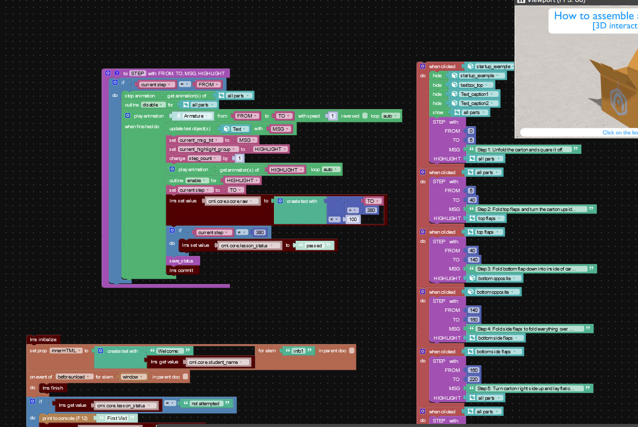

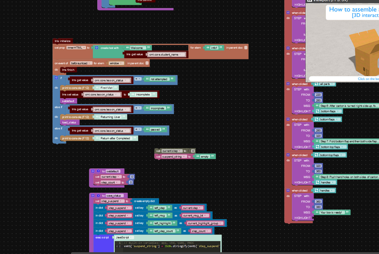

First I rewired your Elearning box demo so it saves and resumes from where the user leaves off. Nothing fancy there and I did a messy job (see screenshots)…just a proof of concept that Verge SCORM 1.2 puzzles provide everything needed for creating very advanced SCORM modules.
I further modified it (not shown in any of the ss) to be able to also save and load a resume string from an external server (via ajax call)… well almost. My ‘external’ server I got it working on was still local.. when I uploaded to SCORM Cloud to test, it threw a Mixed content error as their Cloud is https and my local server’s SSL is no longer setup..doh..

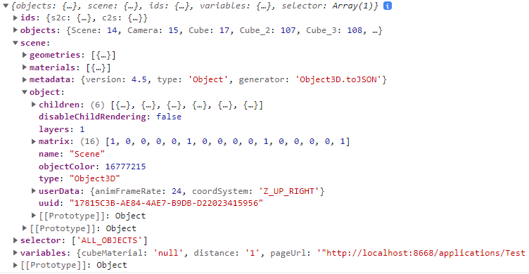

Alexander KovelenovStaff2022-07-31 at 6:23 pm #54536kdv
ParticipantAfter exporting to JSON and parsing from JSON the object looks like this
Any ideas how to convert this object to a normal Object3D? Some kind offromJSON()is needed )))Indeed, having local storage supported in Puzzles would be very useful
The best solution to realize an app’s state saving/loading. It would be possible to save
_pGlob.states[0]and restore this state on loading…Puzzles and JS coding. Fast and expensive.

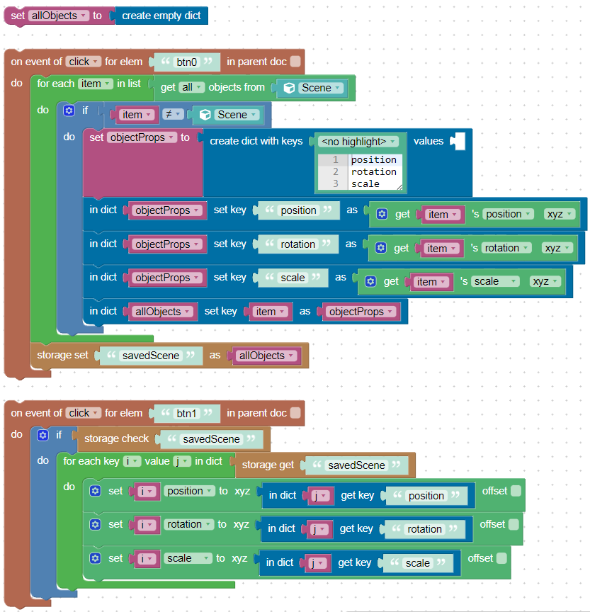

ParticipantIn general, that’s an individual task depending on what exactly you want to save/restore.
Here’s a simple set of puzzles to save/restore objects’ position/rotation/scale
Link to zip https://v3d.net/q7q
