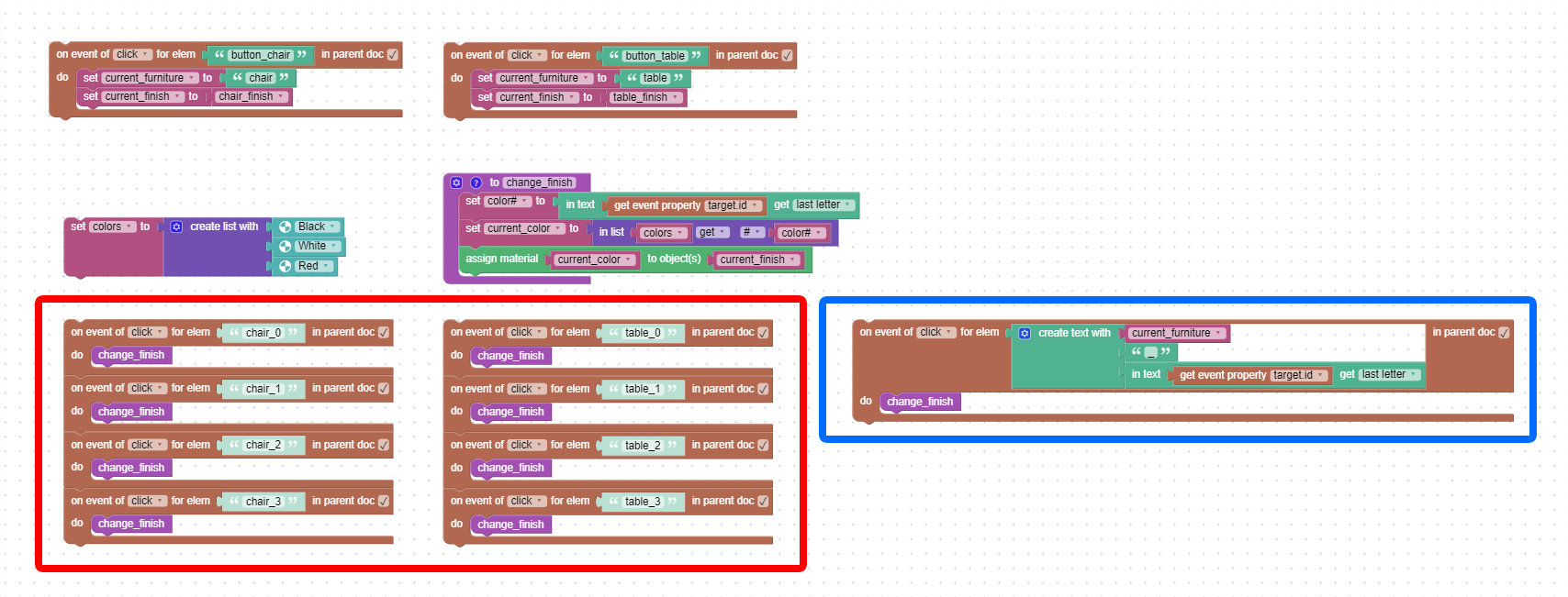

    I think I dint explain well. Here I am attaching an images where 1st puzzle at top shows what happens when user clicks a button on website, then in 2nd row I have defined a procedure and list of colors.
    In third row currently I have defined the triggers which are in red box but it takes lot of time to define hundreds of objects and colors like this so I want something like I have created inside the blue box on right. I know there’s something wrong in that but if I could do something like this, this one puzzle will replace all hundreds of button triggers.

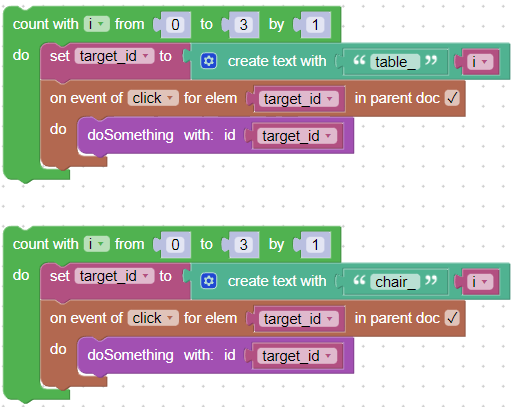

    The puzzles inside the red frame can be reduced to two loops. That will register an individual event listener for every button.

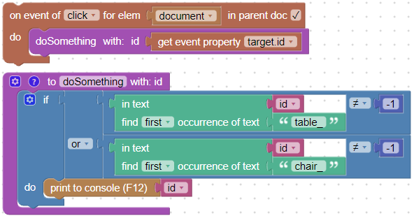

    Or you can create only one event listener for parent.window or parent.document and then detect the clicked button by target.id
    The puzzle in the blue frame won’t work. It uses variables and parameters that are undefined at the moment of registering this event listener.

    to somehow make use of that blue marked puzzles.
    The on event of puzzle just registers an event listener for the chosen element, it executes no visible actions. The action will be executed only when the event happens. Your blue marked puzzle won’t work because target.id is undefined at the moment of executing this puzzle (on the app loaded). And the variable is also undefined. It will work only if you add a button with id undefined_d. target.id can be read only inside the on event of puzzle when this event happens.
    If you want only one on event of puzzle to affect all buttons then use document or window as a target. Thus when you click some button on the page you can read its id (table_2 or chair_3) and do some actions according to that id.
