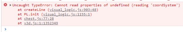

2023-07-03 at 1:30 pm #64974David Duperron
CustomerHi again,
Anyone here to explain to me how to use the “create line” puzzle that is included in the ruler plugin? I can’t figure out how to use it…
Thanks!David
2023-07-03 at 2:00 pm #64975kdv
ParticipantThat puzzle is not working. It has an error in its code.

2025-07-03 at 1:10 pm #82718David Duperron
CustomerHi,
The SphereBufferGeometry constructor should be replaced by SphereGeometry. You can do it yourself in the ruler.block file, and it should work. -
