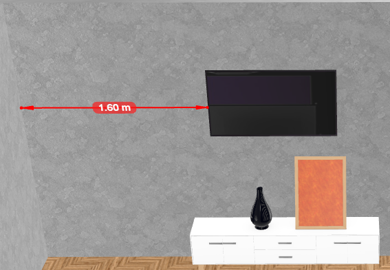

    This is great. However, I see in the example that you are only able to click on the room. Is it possible to measure the distance between the TV unit and the wall to the left for example?
    #67636
    Possble if you add TV or any other mesh to the list of objects to be measured. In that demo only walls and floor are in the list.
    Or you can click on the wall near TV to get the distance…

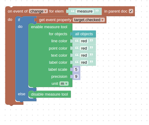

    So I paid and got this plugin. I have set it up but I can’t get it to work. I use the ‘enable measuring tool’ puzzle and add the objects I want to measure to the list but when I hover over them my cursor changes to a circle with a line through it and the tool doesn’t work. I don’t see any documentation, is there something else I need to do?
    #68035
    Show your puzzles.
    #68036
    baz.schonfeldt
    See attached. The referenced element is a checkbox in the html
    #68038

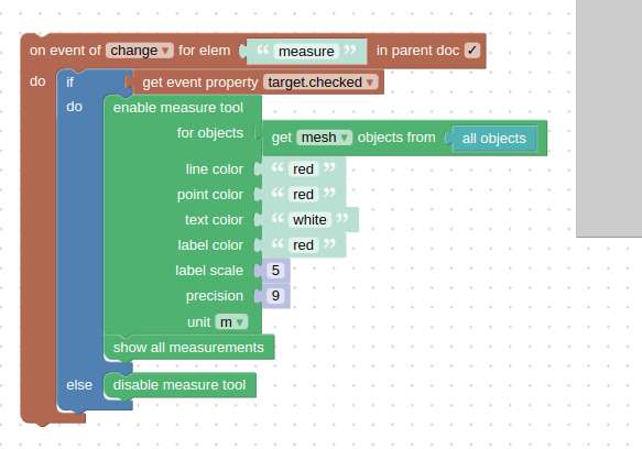

    Ummm… Very interesting logic. Espesially all colors beeing red…
    Replace all objects with this set of puzzles:
    Only meshes can be measured, only meshes have geometry.
    #68040
    baz.schonfeldt
    …Still no joy. I’ve also added the “show all measurements” puzzle but still nothing

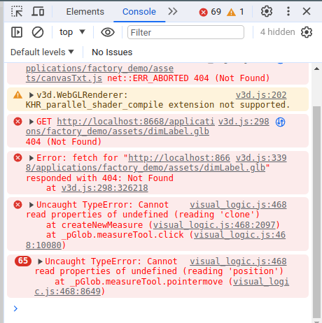

    Show the console log.
    #68043
    baz.schonfeldt
    …your wish is my command..
    #68045
    Now open readme.txt and read the text inside.
